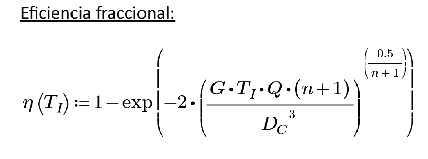

Hi, everyone. I´m trying to make a calculation with different inputs values. I looked on the forum but with my little experience I can´t made it yet. May be, my case is more simple than the examples. So I prefer to ask
My input is a diameter particle (x). With that I need to calculate Ti, and with Ti obtain n. Which is an efficiency.
Then, it will be excelent make a table with my inputs "x"  on a column, and the efiency "n", on another column. Finally, make a graphic with both.
Also, I take this oportunity to ask. In the future I will need to find the minimal number of "x", which make the efficiency n=1.
The calculation is for the efficiency of a cyclone to separate differents particles depending of their size. So, I want to know in parallel with the other calculation in the same sheet, the smaller particle which I can have a 100% efficiency
I know is probably very simple to do, but I cant.
I attached my problem. All the others variables, are constants.
Thanks to all

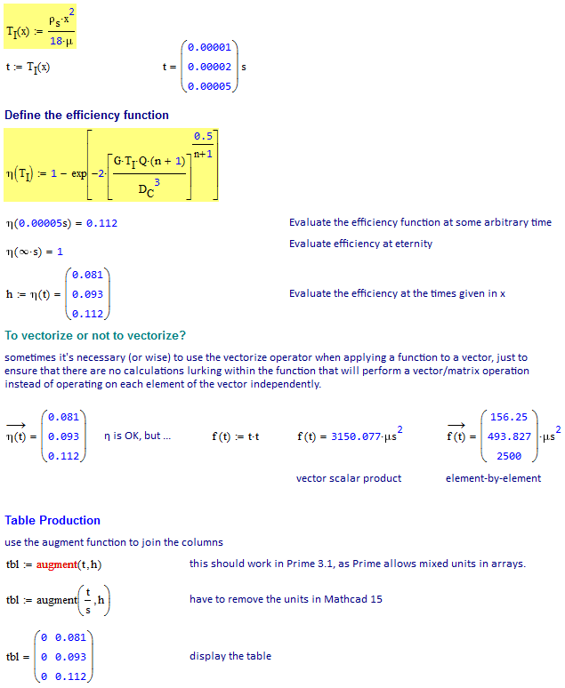

you have to use eta(x):=...T(x)...  and you may vectorize the call to this function.

Your expression for efficiency:

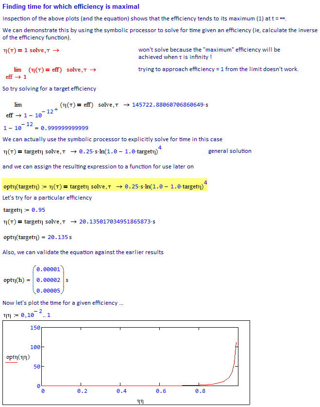

For efficiency to be 100%, the second term must be zero.  Since exp(-N) can never be zero, you cannot have 100% efficiency.  You can get close . . .
Which would mean x-->infinity, looking at the equations and assuming that Emilian means "eta" when he writes "n" here in the forum.

I don't have Mathcad Prime available at the moment, but the following should readily convert from Mathcad 15 to Prime - you could even use the conversion program to convert the attached worksheet to Prime.
First bit - building a table.  Create a vector from your time-dependent function and then simply augment the time value vector [x] to it.
Second Bit - Plotting.  Slightly different in Prime, but you should be able to insert a plot and then type in the effeciency and time vectors ...
Third Bit - solving time at which maximum efficiency occurs.  Use the symbolic processor to do the inverse calculation, and in this case you're lucky enough that there is an explicit general solution that you can make into a function.

Hi, thank you all for your replies. Finally I made this with your help. I attached the two problems for you to look. It would be very helpfull to know what do you think about this.
For the graphic, I have put manually  an interval of numbers because I didn´t know how to put a reference for all a spectrum of values, like 1 to infinit or something like that. Sorry if is very basic my questions but is very new for me
