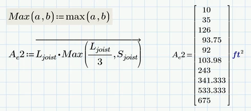

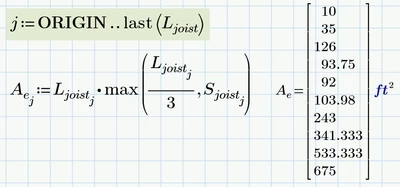

You are on the safe side if you use the system variable "ORIGIN" and the "last" function.
This way, your calculations are independent of the current value of ORIGIN.
You can also dispense with the range variable altogether if you use vectorization. However, “max” is a function that cannot be vectorized, which is why we define an auxiliary function “Max” and then vectorize it.
