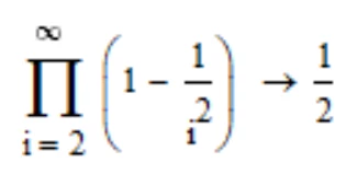

Hi. In my book about mathcad i have a formula (upper image), and i was try write this formula in mathcad (lower image). But result does not match. Maybe i lose some arguments?
terryhendicott
the value in brackets when "i" = 1 is 0.  Multiply anything including a large number of products is zero.
set the limits of the product from i=2 to n.
Cheers Terry

The produttoria must start from 2 to get as a result 1/2
GLeBaTi1-VisitorAuthor
Oh. Thanks! Maybe this book hame misspellings 🙂

In Mathcad or Prime you can also use a shorter (but mathematical somewhat sloppy) notation:
