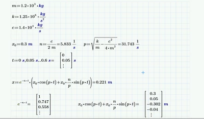

Multiplying range variables doesn't work
x should have more values depending on t. Why do I only get 1 value?
If I separate the terms they work as they should

You defined a range t and in the same region you numerically evaluated it (the = sign after the definition). This is an undocumented trick to turn a range into a vector.
So t is a vector.
x is defined as a product of two factors and as you show yourself in the last line, both factors are vectors. And the "normal" product of two vectors is ... one single scalar (dot product, scalar product).

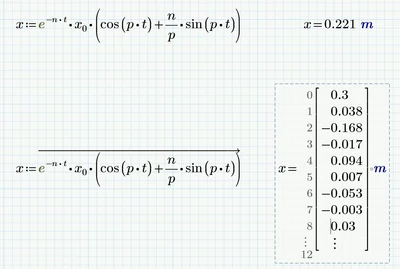

To get the result you expect, you must vectorize (the arrow operator over an expression) the right hand side of the definition of x.

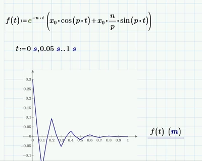

Thank you for your answer! After some trial and error with easy examples I realised that multiplying 2 vectors results in multiplying both elements from the respectiv row and adding them up.  The way I managed to fix this is by turning it into a function.
In case it might help someone

Yes, thats exactly what vector dot product (inner product, scalar product) means 😉
And if you apply vectorization, you get the result you expected. See her for comparison:

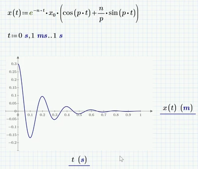

But turning the calculation into a function as you finally did usually is the better approach anyway. You need the t-range just for plotting and you sure should choose a smaller step-width:
