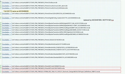

In my company, we use a library of files, which are included in our projects. These files can be for example datasheets of components, formulas out of toolboxes and so on. If we open a project file we encounter very often the problem that include files are marked red, meaning Mathcad reports an error with the file. The fact is, that there is no error in the file:
We found a workaround for this, but this takes a lot of time. When you edit the path, you can force MathCad to reread the file and the error is gone. This has to be done for all marked files. Sometimes even this does not work. Then you have to open the corresponding file, recalculate and store it again.
As we have include files, which include other files, this can get very very nasty. I reported this already more than 2 years ago, but no reaction. Now this problem got even worse. As the network path changed, MathCad hanged or got extremely slow (hours !), when opening a file with include file paths still on the old, not anymore existing, network location. After updating the paths, we still encountered this problem. I found out, that MathCad somehow "remembers" the old paths, even after correcting the paths. Very odd. I opened the Mathcad files with a text editor and found out, that the old network paths were still stored inside the file, even after correcting them. Besides I found out, that data from included files are somehow stored in the current Mathcad file, despite the fact that we disabled caching on all files. I also observed that, when I create data arrays, the file size gets bigger with the size of the arrays, even when disabling caching. I would not expect this. If caching is disabled, I would expect Mathcad to recalculate the complete sheet and to reread and recalculate all included sheets, even sheets included in included files and so on.

Here is an example of a file I mentioned above:

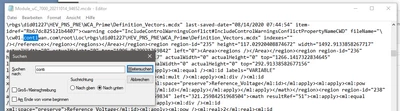

None of the included files contains a path including the string "conti":
When I open the file in a text editor, I can find paths containing "conti". This paths do not exist anymore, which lead to the problems mentioned above. But none of these paths are used in the Mathcad file. This is very odd:

The problem is that Mathcad somehow tries to access "old" paths, which I did not specify in the file, see above, but are somehow inside the .mcdx file. This leads to the problem that already opening this file needs 30 minutes or longer. Recalculating didn't change anything.
For this file I had to open, recalculate  and store all include files and all files included by this files and so on, down to the lowest level. Takes me hours of work and we have a lot of other files. In my opinion this is a bug in Mathcad. why should it store and access some old paths, which are not anymore existing in my file?
Additionally when I saved this file it took another half an hour to save it as long as the "workaround" was not done.
