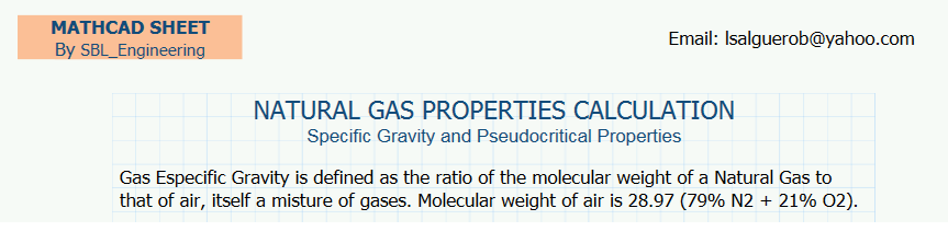

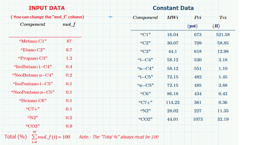

Dear PTC Community Users.
I attached a simple file about Natural Gas basic properties: Specific Gravity and Pseudocritical Properties.
Regards
SBL

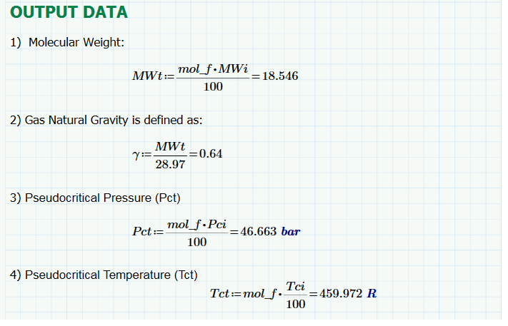

Mar 24, 2015 9:20 AM UTC
Here is a screenshot of this document:
