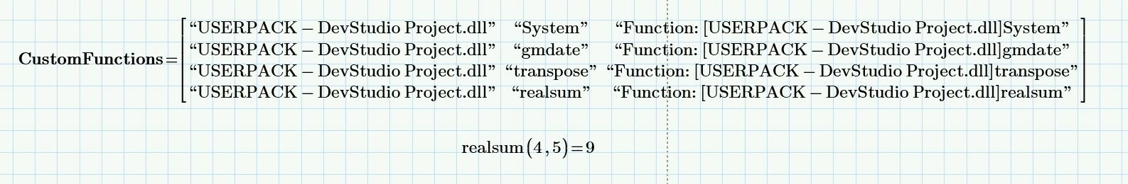

This actually works I tested it.  Earlier one does not.  Visual C++ 2022 solution.
You should expect this when you place resulting DLL in C:\Program Files\PTC\Mathcad Prime 11.0.0.0\Custom Functions.

Here is Visual C++ solution for adding two values together.
Hope it helps
terryhendicott
Jul 15, 2026 10:36 AM UTC
Hope this helps Visual C++ 2022 solution file.  Assumes Prime installed in default location.

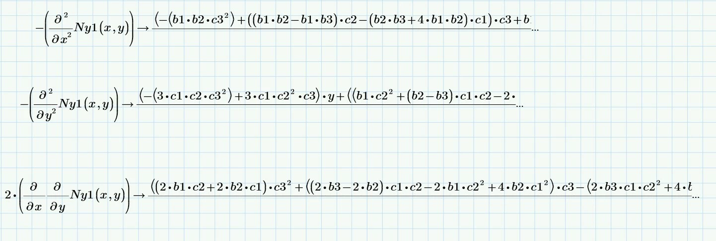

“My goal is to move large engineering calculations from Mathcad into C++ DLL libraries”.  “I hope to use AI to help convert my Mathcad algorithms into C++”
Neither the custom functions nor API can convert Prime calculations to C++, but do not give up hope.
I have successfully this week using chatGPT converted eighteen large partial differential symbolic equation results from Prime equations to C++.  Also for FEA work.  I want them in C++ for speed and to handle larger matrices than Prime can handle.  Prime is great for the theory.
Prime files are simply a zipped collection of internal files.  One of those internal files called worksheet.xml contains regions that each represent a single Prime equation.  Communication to chatGPT was facilitated by exchanging the individual xml text of the equation regions.  chatGPT has learnt the syntax of these text regions and can convert them to C++.  It took three days for the translation as several attempts needed to be made to convert and properly and methodically test the C++ results.  Manual intervention was needed to finalise all eighteen as the conversion by chatGPT was not entirely correct.  Not everything in Prime is translatable like this to C++, An integration equation for instance.
chatGPT has learnt the internal Prime syntax from work I did a few weeks ago.  Refer to an earlier post https://community.ptc.com/mathcad-7/primeconnect-c-prime-c-174812.

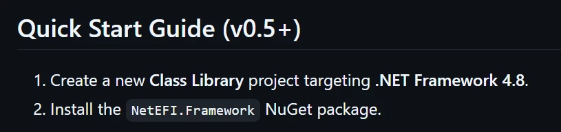

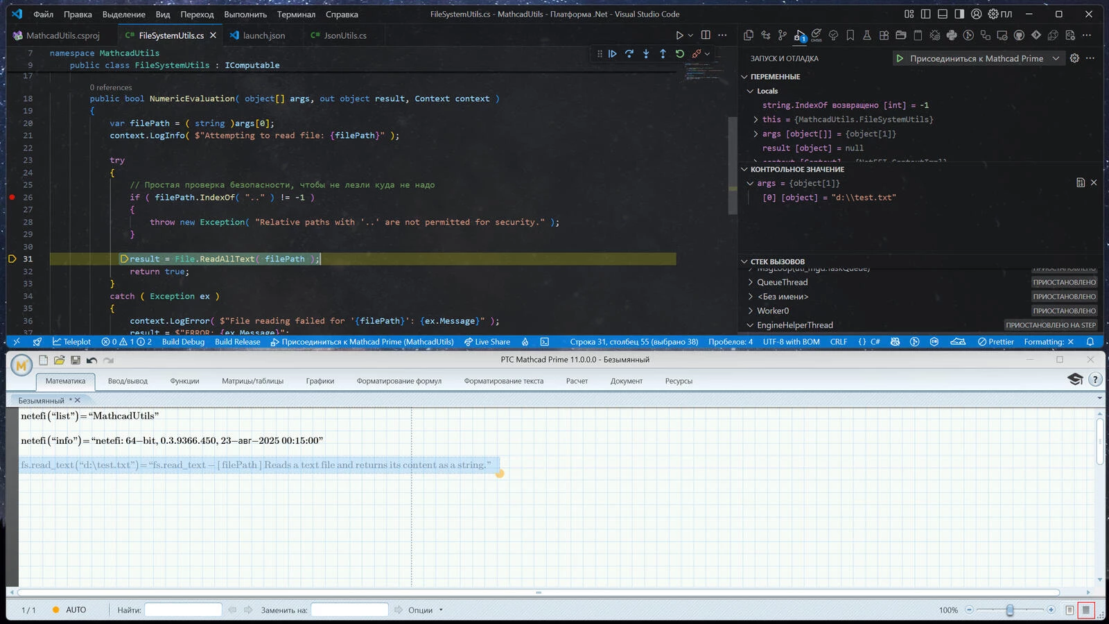

The Universal Way: https://github.com/ViacheslavMezentsev/NetEFI
NetEFI Framework for Mathcad
This framework allows you to create user-defined functions for Mathcad 15 and Mathcad Prime using any .NET language (C#, VB.NET, F#, C++/CLI). It removes the need to write C++ code by providing a simple, attribute-based API, allowing you to focus on your function's logic in a familiar, strongly-typed managed environment.
You can see how the project itself is designed. The project's structure allows it to be compiled for all versions of Mathcad, starting with version 15.

Got sample working for Mathcad 15 following Quick Start Guide.
:Could not and have tried multiple times to get it working in Prime 11:
Can you please provide a working Visual Studio solution for PTC Mathcad Prime?
Cheers

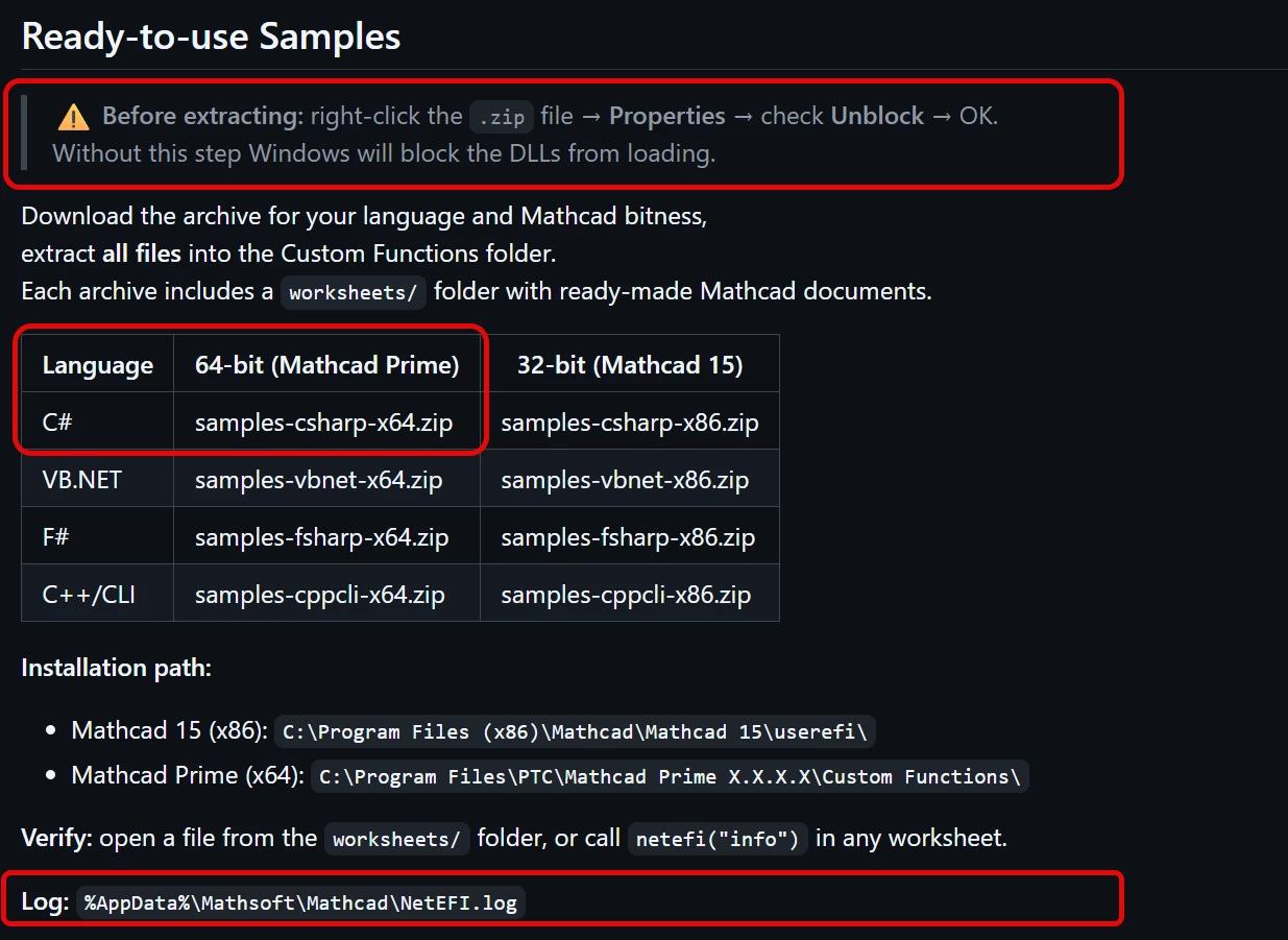

Jul 18, 2026 7:55 AM UTC
The releases page includes ready-to-use builds you can try before building your own. The path to the log file is also provided in case of any issues.

Thank you for this simpler way of writing custom functions.  Have got a successful compile and examples are running in Prime 11.  Thank you so much.
Jul 18, 2026 7:34 AM UTC
If problems arise, you need to look at the log file:
 C:\Users\User\AppData\Roaming\Mathsoft\Mathcad\netefi.log
It contains information about the launch
