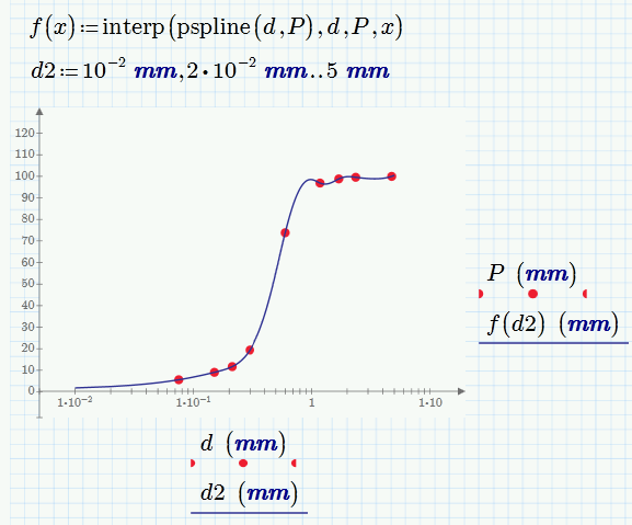

See please the attach.

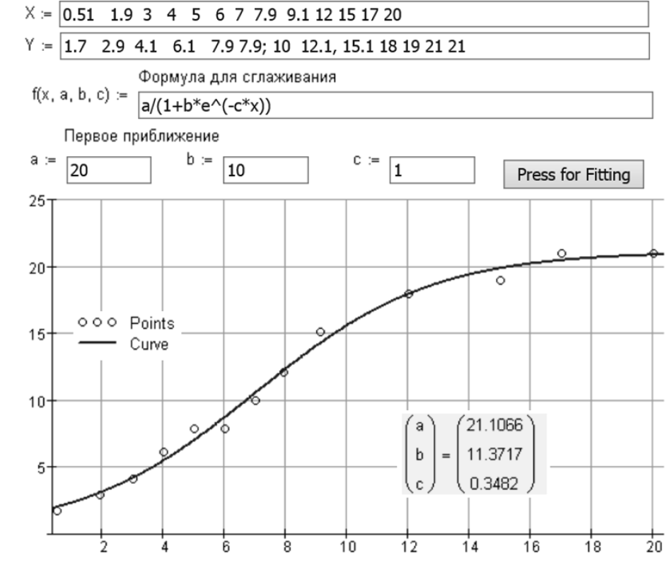

But you need not a spine interpolation but a fittings.

So here is a file using spline interpolation and a few regressions.
Valey is showing a logistic model but with different data compared with the Excel sheet ?

April 24, 2016
Thanks.
So I see what the problem is:
This second abscissa value has to be either an undefined variable (if you dispense with the units) or a range variable. I had shown how to do it in my first reply - here is the version using units
April 23, 2016
When you create the plot you just need to increase the step for the variable argument of function.
