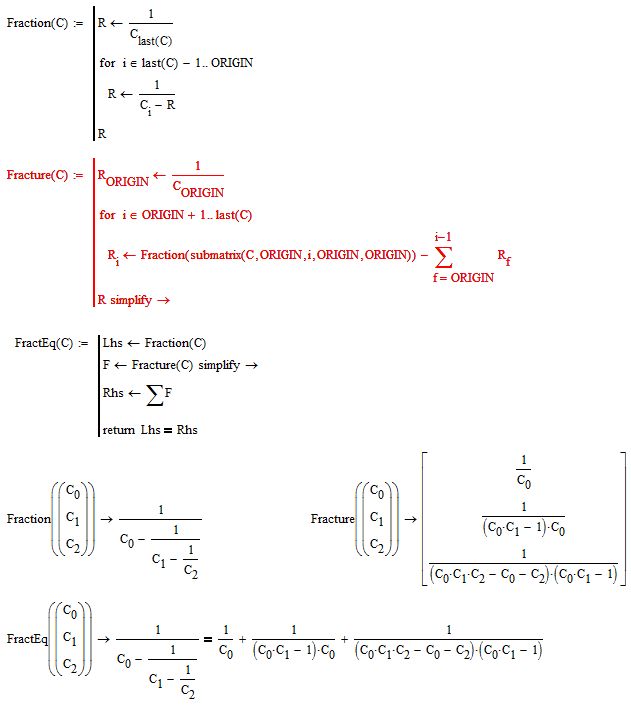

  Hello, Everyone.
Need help in a creating program function like as the above.
   Thanks in advance for your time and help.
       Regards.

OK,  a little perseverance and it's done               in Mathcad 11.
And with an array of 5 elements it gives:

You want a program that will create that symbolic expression? I doubt very much that's possible.
-MFra-
Hello Richard! my answer doesn't fit?
I think what Loi Le is requesting is a function that creates the expression shown.
23-Emerald V
Part of it is at least possible:

23-Emerald V
Here you go:
Then there are the smbolic simplified results:
To get at the sum of fractions with all numerator equal to 1 is going to be difficult, because the symbolic processor doesn't usually 'follow orders' easily.
But at least I got it to check:

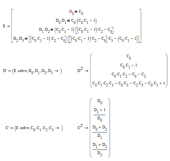

  Hello, Everyone,
  From :
  Thanks in advance.
      Regards
          Loi.
You can't solve one equation for four unknowns.

   I got it. Thanks, Richard.
