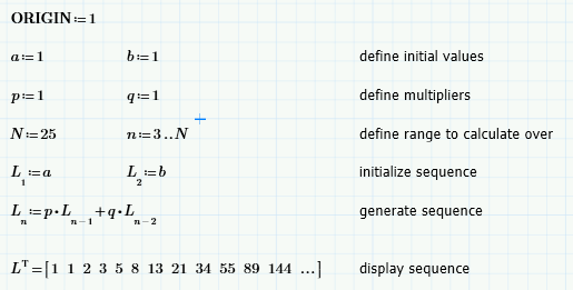

You will need to look for help about "range variables", plus basic expression entry and editing.  Here's an example of how to create a similar sequence
Stuart

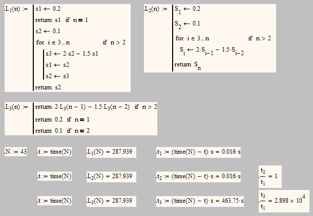

September 22, 2015
Maybe you'd like zo create a function to get the n-th element of the series.
As you can see, the most obvious implementation (recursion) also is the most inefficient one.
