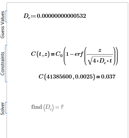

Need help solving the following equation to calculate chloride ingress into concrete
Hi All
I am currently trying to solve the following equation for Dc. I have tried to do it as seen below, but i dont know if i am getting this completely wrong? Any help would be greatly appreciated.
Many thanks in advance
Daniel Wright
Werner_EAnswer
February 10, 2017
Its hard to play with a picture, so for future questions please post the worksheet (along with a pic, as many of us can't read Prime 3.1 files.
We also don't see the value of C.0.
You have to define the function above the solve block and also add D.c as argument -> C(t,z,D.c):=....
Here is what it look like in Mathcad 15 (have used C.0=1)
dwright-51-VisitorAuthor
February 11, 2017
Thank you very much Werner, you have been a great help.
