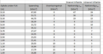

I have attached the file now. And I came to think of it, that alle the values er >0.
Yeah it's 25deg.
I need to put the expression for c.uk into an Excel sheet, because i'm working on an general excel program. The simple program shall be used by my colleagues to determining the soil strength based on a given foundation size, force, depth and some of the other variables in the formula. Which is given based on the foundations size (the s.i factors).
It's looking something like this (in Danish).
So all the variables have a known value depending on the foundations size, depth etc. So manually I could check the result for each 0,1 meters, but that will take for ever..
I hope that makes sense?
