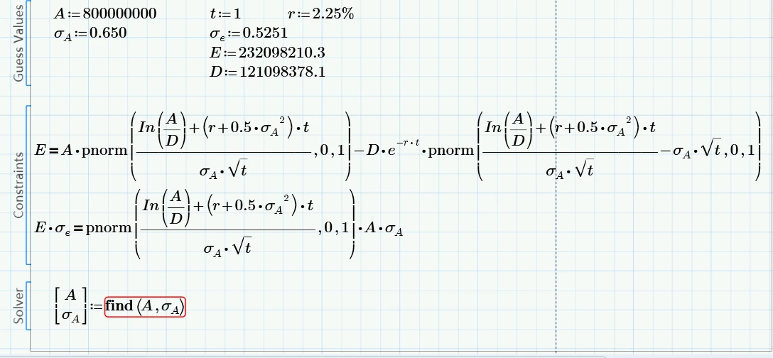

Hi all,
Could anyone help me find what problem within the calculation,
To solve two variables using two equations, but it finally said there needs at least two arguments but is applied to 1, what's that mean?

Please upload the worksheet
I have attached a picture of my calculation. What you mean by uploading the worksheet?
The actual worksheet.
To do this you need to click the 'Use advanced editor' link in the top right hand on the comment box.
