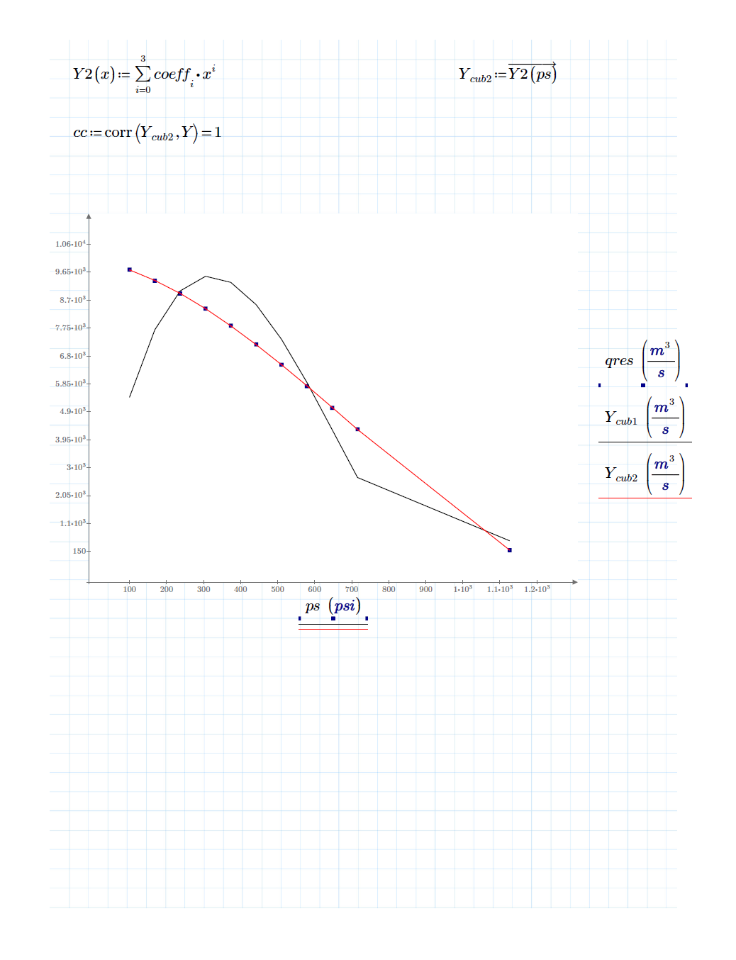

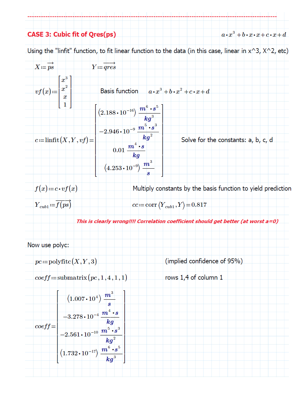

Thank you for your answers.  However, I am still perplexed.  I have enclosed a PDF of my worksheet for those with Prime 3.
Page 6, from the PDF is repeated here:
(ps, qres) are x,y values.  I print out the coefficients from both linfit and polyc (they come out in reverse order, but you can look at the units to compare).  The coefficients for x^3 and x^2 are arguably zero.  But the linear and constant terms are very, very different.  This difference is plotted on page 7 (reproduced here):
The results from polyc seem reasonable, those from linfit do not.
I think that I'm using the correct syntax - but clearly that isn't so!
Bob

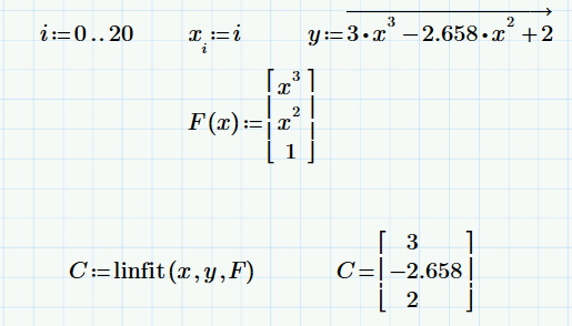

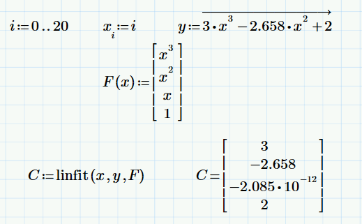

I can't open your file, so I can't see what you did.  But this is linfit in Prime 3.0:
If we knew that the linear term wasn't there, we could modify the function:
