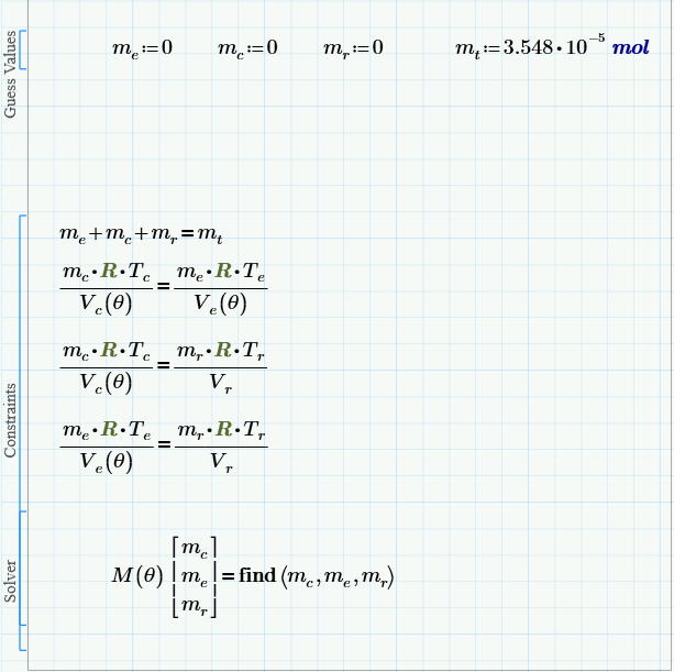

I need some help with a solver block. I have attached the .mcdx fill. I'm trying to solve for 3 variable with 4 equations (constraints) which are a function of theta.
I feel I'm going about this wrong.
Any help is greatly appreciated,
Ken

I can't read your file because it's in Prime 3.1 format, but in general there is no solution to a system of 4 equations with only 3 unknowns (it's an over determined system). You either need to get rid of one equation, or find one more unknown.

I'm afraid 3 of the 4 equations aren't independent:
Your first equation may be OK, But the other three say:
Mc*Xc=Me*Xe, Mc*Xc=Mr*Xr, Me*Xe=Mr*Xr
The second and the third already imply the fourth. Omit that one.
What about those functions V(theta)? How should the solver know/find out about them. And who is Vr?
Then in the solver, your putting yet another equation (=), rather than an assigment or just an evaluation (:=)
And with M(theta) multiplied with the vector: Note that you cannot assign someting to a multiplication.
Normally you would write in the solver something like:
Luc.

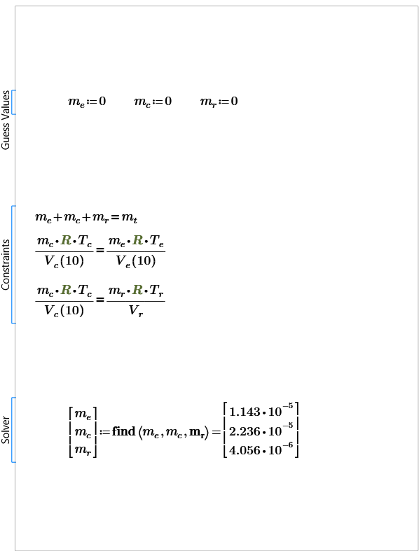

I've gotten the following to work if I put in a value for theta in Vc( ) and Ve( ). Vc and Ve are functions of theta defined earlier in the worksheet.
Can I use a function such as Vc( ) in the solver block?

I understand what Werner is saying. You do have to provide values for all the variables in the solver block. Let me try the symbolic approach as Werner has suggested

Think everyone for the help. I was able to work the problem using symolics.
