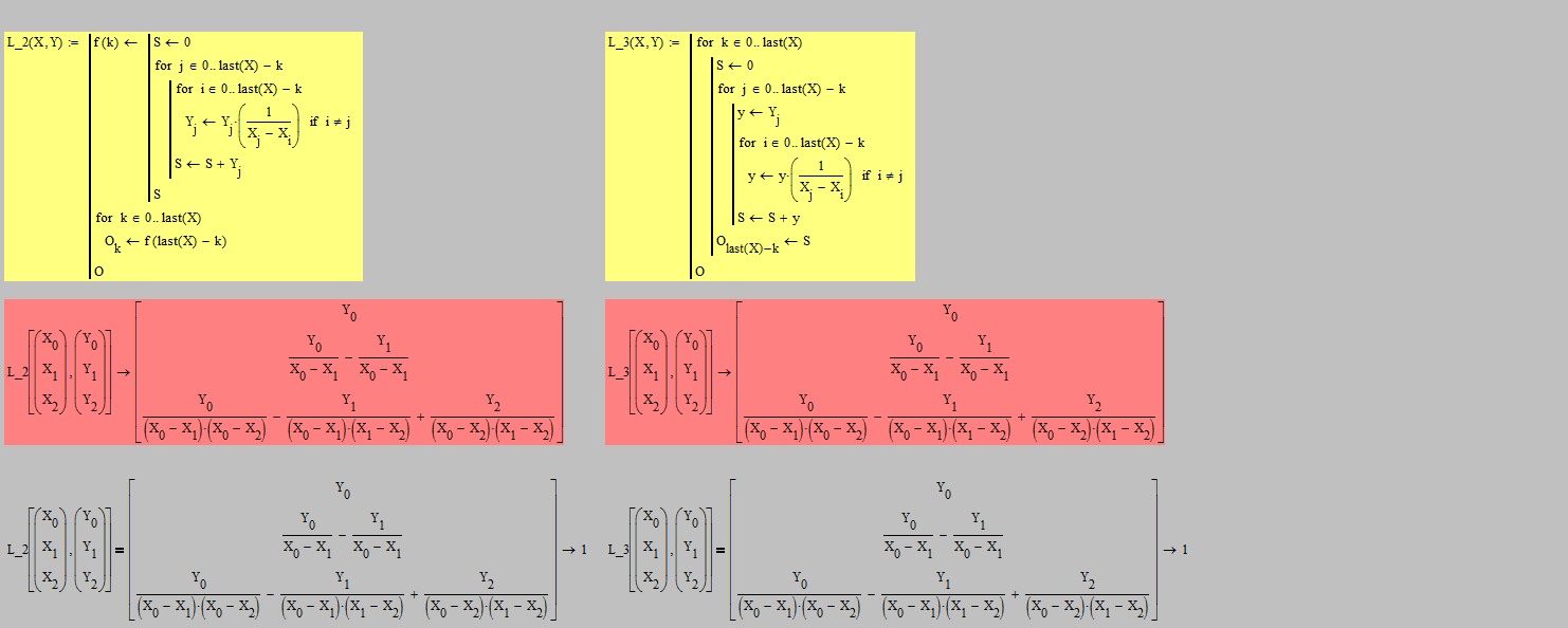

Need help with creating a function.
Hello, Everyone.
Need help with creating a function L_(X,Y) with output as the above. (green highlight)
Thanks in advance for your time and help.
      Regards. Loi.
Message was edited by: Loi Le

Loi Le wrote:
Hello, Everyone.
Hi Loi,
The problem with your function L_ is that it modifies Yj when k=1, so the new value gets propagated into the k=2 iteration.  There are a couple of ways round it: assign Yj to a new variable at the start of each i,j loop or use your existing function L as a local function.
Stuart

lvl10720-TurquoiseAuthor
20-Turquoise
September 14, 2015
  I got it. . Many, many thanks for time and help, Stuart.
     Regards. Loi.
23-Emerald V
September 14, 2015
No worries, Loi.  I like to keep an eye on your posts and look at the interesting results you get.
