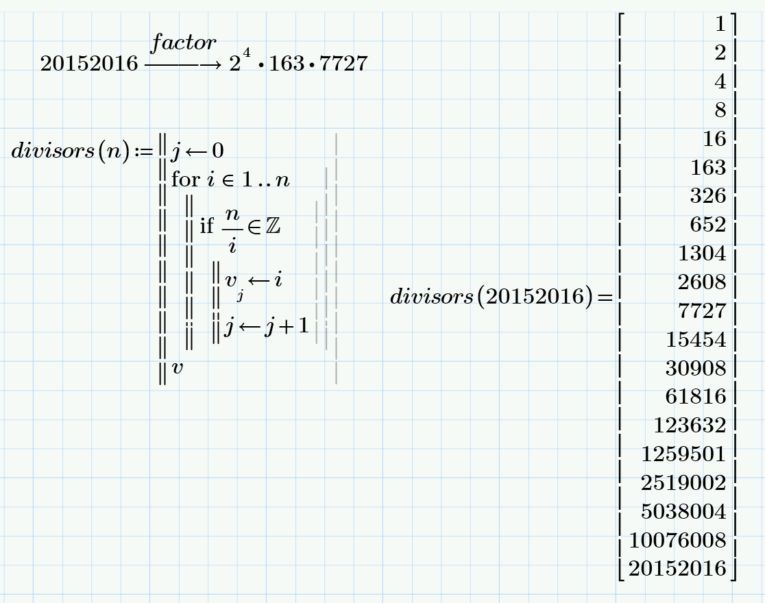

Need help with creating a program function for "How many divisors does 20152016 have ?"
  Hello, Everyone.
     Thanks in advance for your time and help

This gives all the proper factors of a number:
18 replies
RichardJ19-TanzaniteAnswer
December 24, 2015
December 24, 2015
Prime
December 24, 2015
You only need the loop to go from 2 to floor(n/2). 1 and n are factors, but they are not proper factors (and can be easily added outside the loop if desired).
