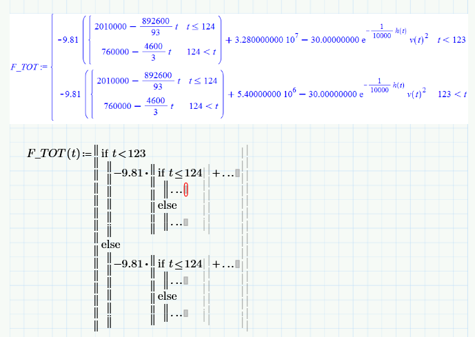

hey could someone help me with this ? i need to putt this function into mathcad prime 3.1 and i have no idea how to do it. help

See please the attach too

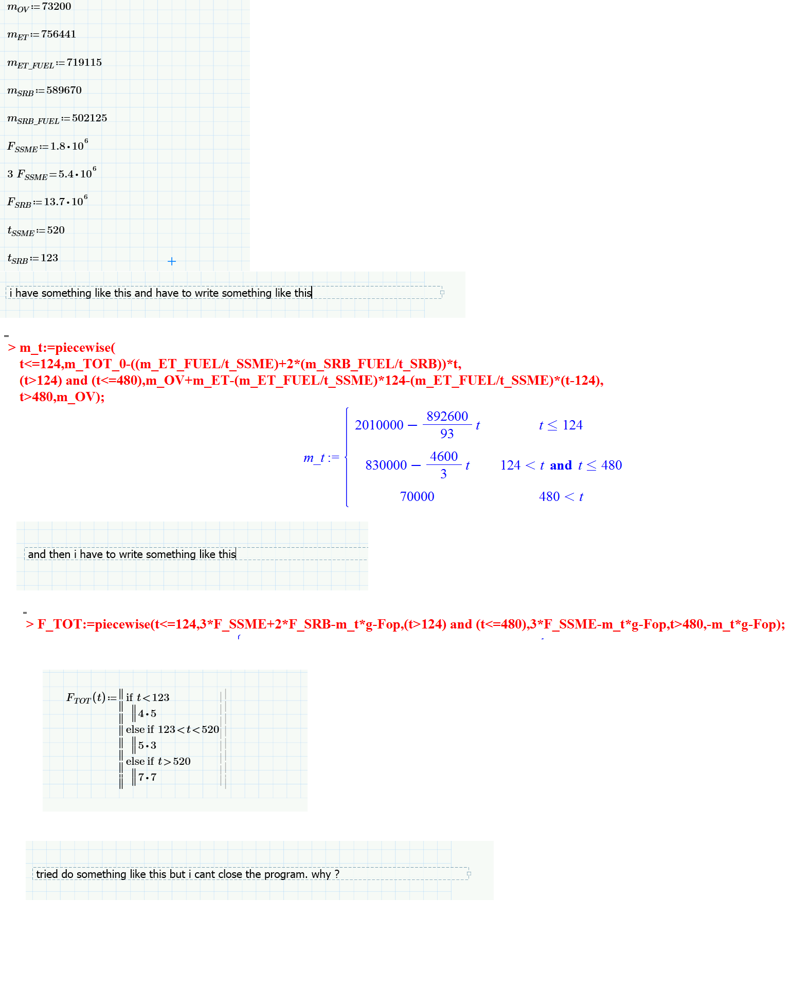

hey, i need to write a function like this, i dont know how to write 3 variables of t. can someone help me.pomocy.png

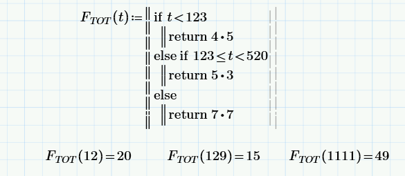

You need a return statement to make the program return a value and then exit:

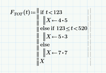

Or you could assign the values to a variable, and put the variable on the last line:

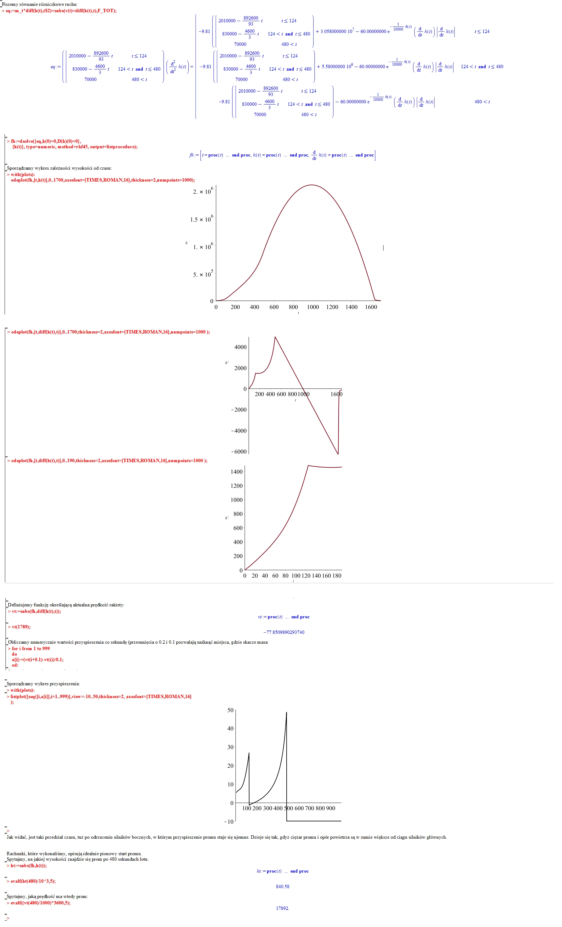

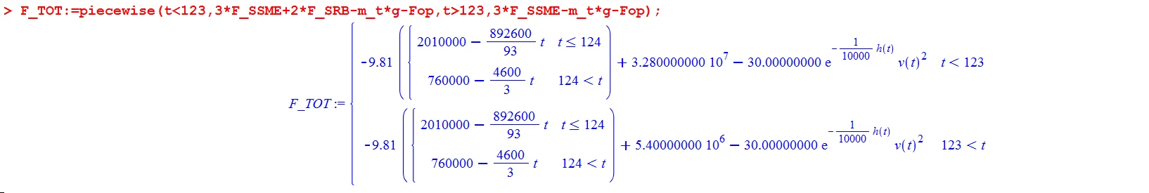

i figured it out but thanks. but i need help with differential equation. so far i have something like this(mathcad file) a have to do something like this(screenshoot). i wolud appreciate any help. i also made a post i physics section.
