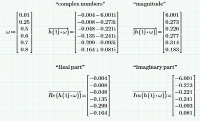

You have to vectorize your expressions (put an arrow above it, look that up in the 'Operators' section on the Math ribbon. It's in the lower-right corner:
I'll leave the phase to you..
The table is easy to reproduce except for the argument at w=0.8. Note that the phase runs on negative continuously, but the argument of a complex number is generally limited to between -pi and pi, or -180 deg and 180 deg.

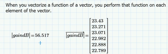

Because gaindB is a vector taking the magnitude results in a scalar.  Vectorize:
The numeric value on the right-hand side of each equation is substituted for the name on the left-hand side in the expressions that define the model. No checking is done during the substitution to determine whether the substituted value is valid.
23-Emerald I
Look up vectorize

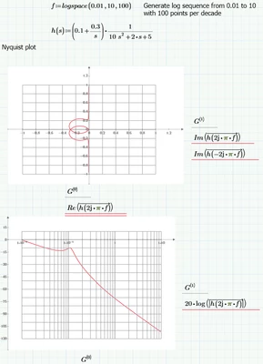

How to put grid in the graph in Mathcad Prime for Bode Plot (Magnitude & Phase Plot's)?
Or is it only possible if we use a chart component or something like that?
23-Emerald V
The standard plot of Prime does not come with grids, but there are several methods to put in a grid.
The 3rd party add-on chart-component does provide grids, but it doesn't deal properly with units (as far as I know).
Here's the result of my grid routine
