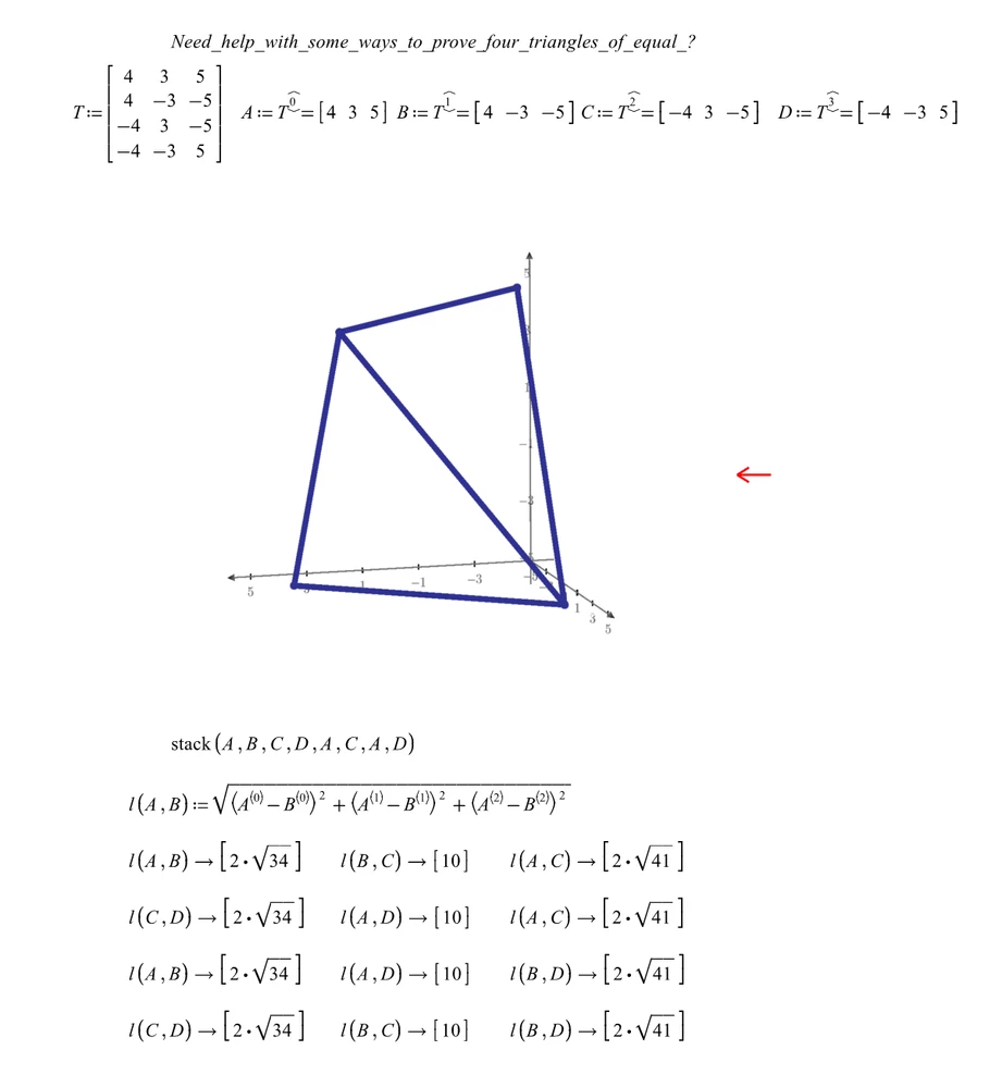

Need help with some ways to prove four triangles of equal ?
Hello Everyone.
From the following :
Thanks in advance for your time and help.

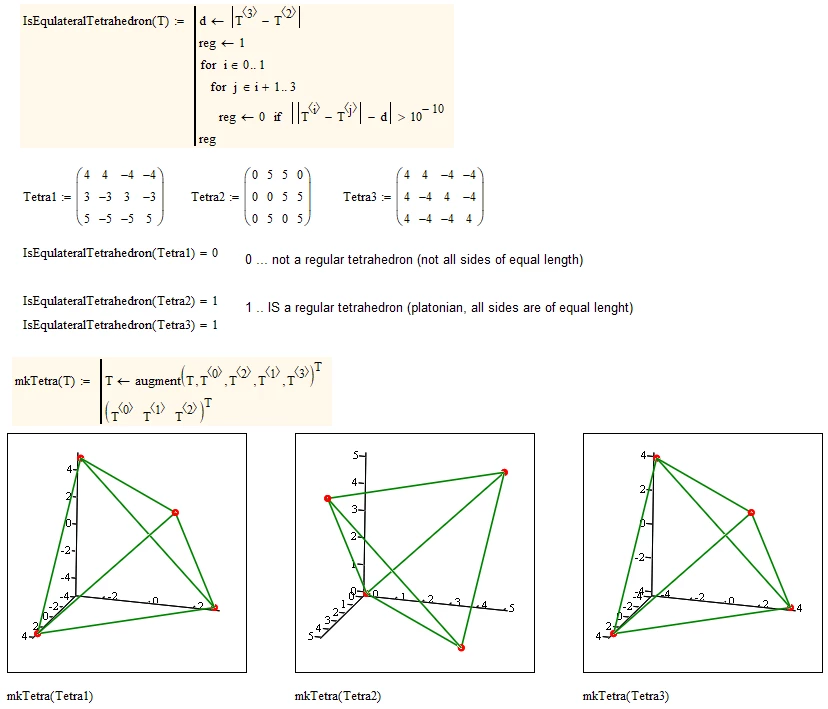

I greatly appreciate your time and help, Werner and Tokoro. @ Tokoro, I only have MC15 and I understand your hint as the following:
Best Regards.
