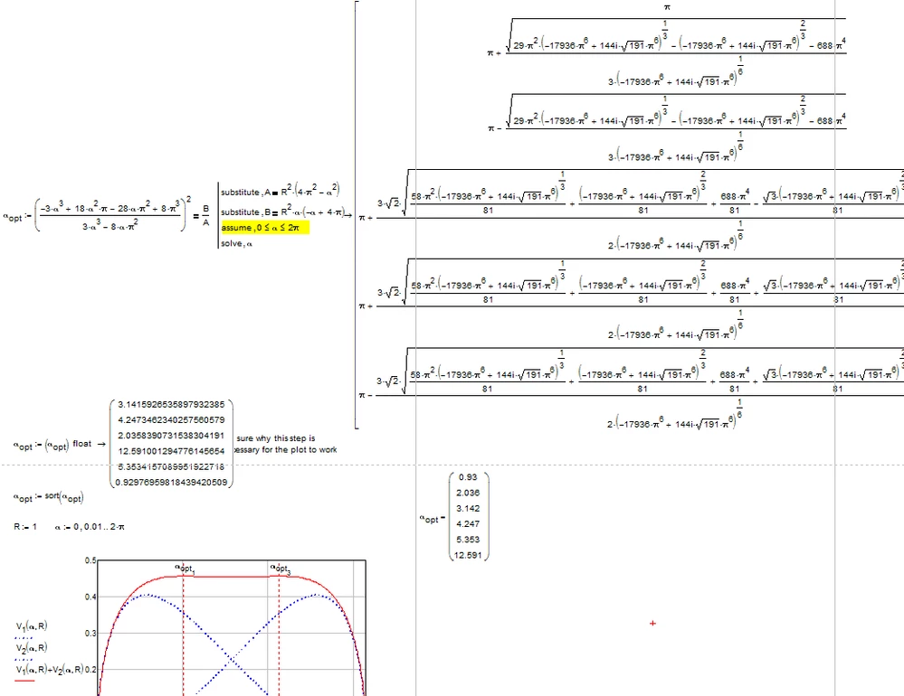

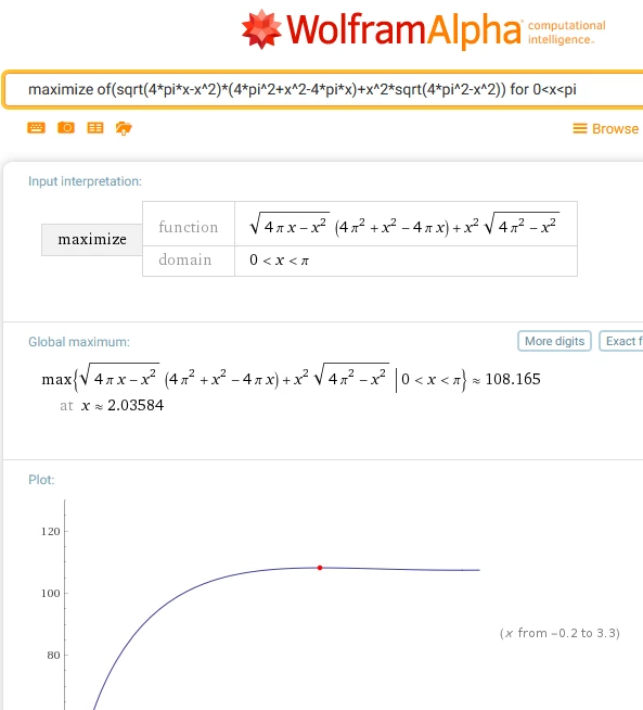

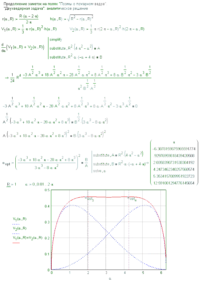

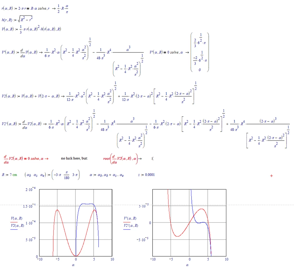

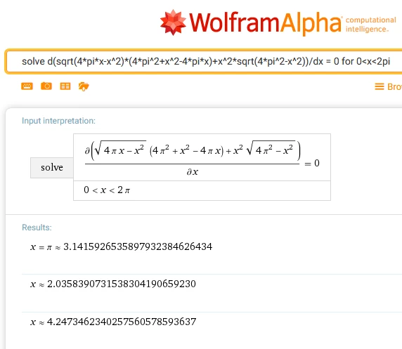

I have got the solution for the V function, but I cannot have got the solution for the V2 function!
Help please!
The Mathcad Prime 5 sheet in attach!
The problem.
We take a round workpiece and cut a sector out of it.
We then fold the cone from the workpiece.
The question is what is value of the cutting angle at which the volume of the cone will be maximum.
I solved the problem with one cone analytically, but I cannot solve it analytically for two cones!
