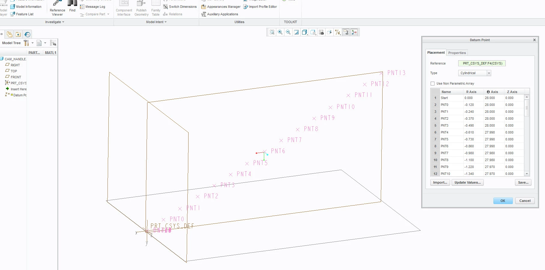

Need to create Cylindrical Datum Point(s) X,Y Feature in Creo using export from MathCAD
First I only have MathCad Express Prime 3.1
Created a spreadheet that gives me the X,Y points for my spiral
Copied the X,Y outputs from Excel into MathCAD
How do I create a Datum Point Feature using this X,Y output from MathCAD?  When I click on import while in the Datum Point (cylindrical) feature it only allows things like pts file.
'll keep plugging away at it but if anyone has ideas that would be excellent

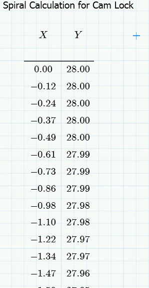

Does your problem lie with Prime (doing mathematical operations etc) or with Creo (what many people frequenting this community do not know/use)?
I see in pcture2 that you have a table of X,Y points in Prime. Is there a mathematical operation needed to be performed on this data? If yes, what is it?
Then for the export from Prime to Creo, you may be better off asking in the Creo community.

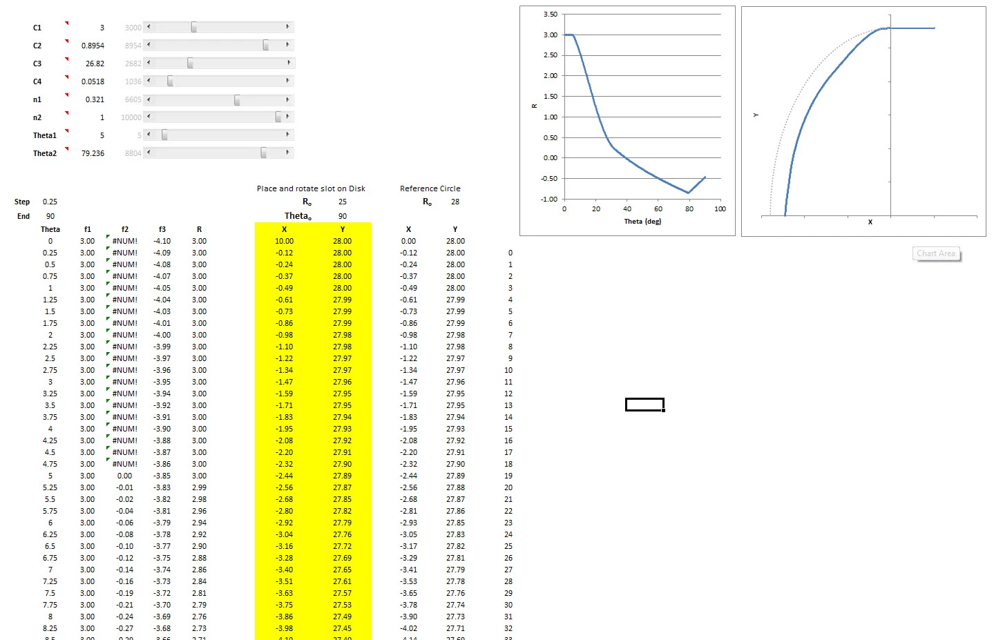

First question  is how to get this into MathCAD....
Here is the spreadsheet someone created to create X,Y points for a spiral.....
I can change cell B21 to set the increment.. and for this cam lock only interested in the X,Y data up to 90 degrees....
Would love to get this into a worksheet in MathCAD!
The second issue would be how to export the X,Y points directly into Creo.. Which  I can ask the Creo community directly...

I've peaked at your EXCEL sheet; and run into the reason I'd rather use Mathcad--it would be difficult to reverse engineer what this sheet is doing.  If you can give a simple explanation of what this sheet does I'm sure one of us lazy types can put it into Mathcad for you.
Which version of Mathcad would you prefer?  version 15, or Prime?
