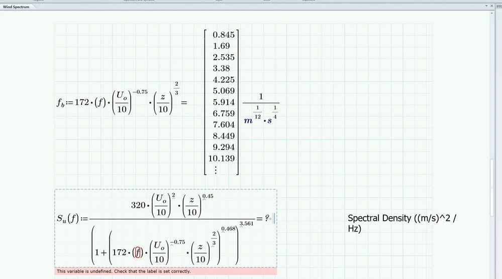

Need urgent help for this problem in Mathcad Prime 4.0 , What is the problem here ? The file is also attached in this post.

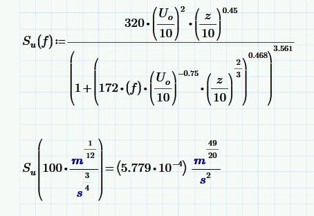

The equations are empirical so not unit consistent.  This is a hint on how to handle the units with Prime.
Cheers
Terry
February 21, 2019
The definition of a function cannot be equal to anything.  You need to delete the equal sign on the right hand side.
Cheers
Terry
February 21, 2019
Additionally you may want to check your units
