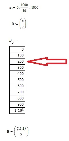

I have created an array, lets call it "a" (11 rows x 1 column) and then I have created a Matrix, let's call it "B" (2 rows and 1 column). The first element of the Matrix (1st row, 1st column) is the array "a".
How can I address to one of the elements of the array "a", contained inside the Matrix "B"?
For example, referring to the attached picture, what is the right syntax to extract the third element of the array (number 200)?

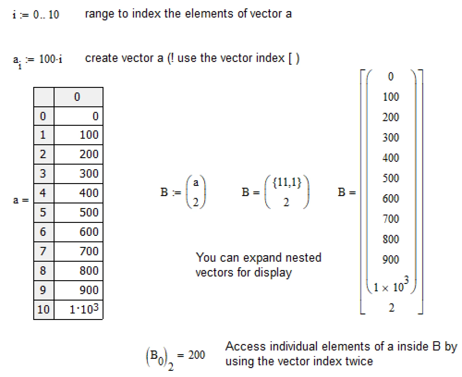

The problem is, that a is NOT a matrix or vector but its just a range!
A range is kind of an iteration loop and you can't access individual values.
If you turn a into a vector you simple use the vector index twice:
