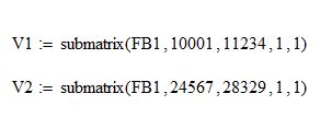

OK so let's say I have found two segments of the original vector FB1 that contain test data of interest and I would like to return the results in one nested matrix.
I can't figure out what assignment statement to use to created the nested array, Voutput

You wind up with an array of arrays
