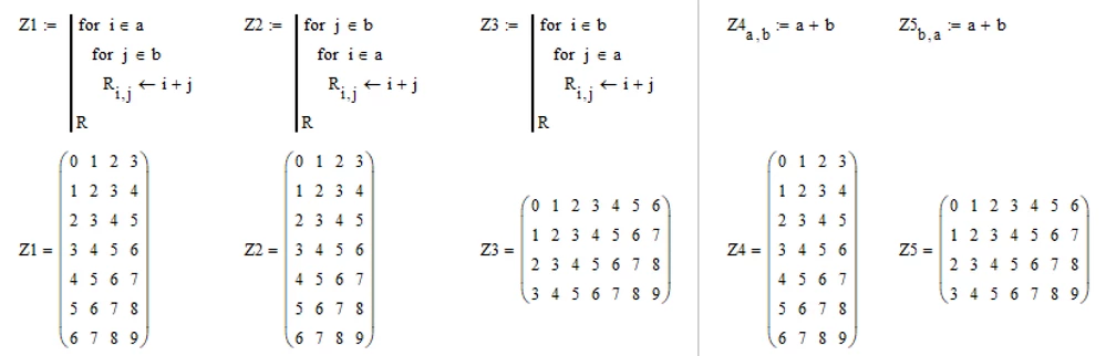

Do you think that one of the calculations below executes faster than the others?
Z4 and Z5 should be a little bit faster, I guess.
BTW, the above calculations can be speeded up significantly by allocating space for the array before the loops

In the attached file in my post I consider the "b" loop as the inner one and the "a" loop as the outer. If you run this you get a trace like this:
a=0, b=0
a=0, b=1
a=0, b=2
a=0, b=3
a=1, b=0
a=1, b=1
a=1, b=2
a=1, b=3
a=2, b=0 .........
which indicates to me that the outer loop "a" is set to 0 and then the inner loop "b" is run from 0 to 3, then "a" is set to 1 and "b" again run from 0 to 3 and so on........
If you then swap the range lines i.e. change
a:=0..6
b:=0..3
to
b:=0..3
a:=0..6
then the trace print out does not change. This indicates to me that now the inner loop variable is set to 0 and the outer is run from 0 to 3, then then inner set to 1 and the outer run again from 0 to 3.
I expected that in every case the outer would be set to 0 and the inner run over its range, then the outer set to 1 and the inner run over its range again etc...  But it appears to be inconsistent in this.
So my question is how does Mathcad decide which loop it will hold constant while the other is run over its range??

You wrote "now seems to be executed fastest" and so I guessed you were talking about execution time.
So you really think that the order the two ranges a and b are defined has any influence on the way Mathcad loops over Z[a,b ? Why do you think so? Changing the order of the definitions of a and b does not has any effect on later calculations which use a and b.
The expression Z[a,b stands on its own when it comes to execution - when it sees the indices a and b it looks up their value and it does not matter at all where on the sheet those variables were defined (as long as its above or to the left). Z[a,b always evaluates with a as the outer "loop" simply because its the index placed first (row index).
Z[b,a evaluates the other way round and will of course give you the transposed matrix.
