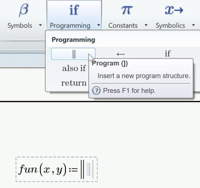

How do i use nesting if then statements for functions? I haven't used this product in a while and can't figure out how to break out of the initial if statement to set up a second one. Is there a guide to this somewhere? can't figure out which buttons to press 😐

You start creating a program by typing ] (or use the menu
Then you can add program lines by typing Shift-Enter

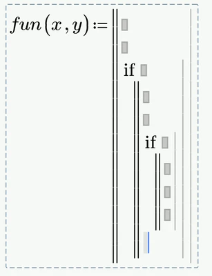

When you are about to insert an if-statement , just do it. You can use the menu, the keyboard short cut (deoends on your keyboard language) or, very convenient, simply TYPE "if" (without the quotes) and follow by pressing Ctrl-J.

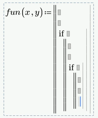

Now you can again add lines by pressing Shift Enter and when you are about to insert the inner if-statement, do it using one of the methods described before. And again you can add lines via Shift-Enter.
To break out from the inner if-statement, you use left-arrow followed by  Enter (or Shift-Enter).
Now you are in the outer for-loop again.
