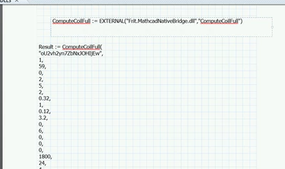

I have a DLL with .Net Framework in c#. I want to integrate this Dll into Mathcad. I tried lots of method to integrate this but software didn't recogniz this Dll. I also add this Dll prime/Custom functions and the same file. I also make a wrapper dll with using c++ and add as reference this c# dll. But it doesn't work. Could you please help me?
