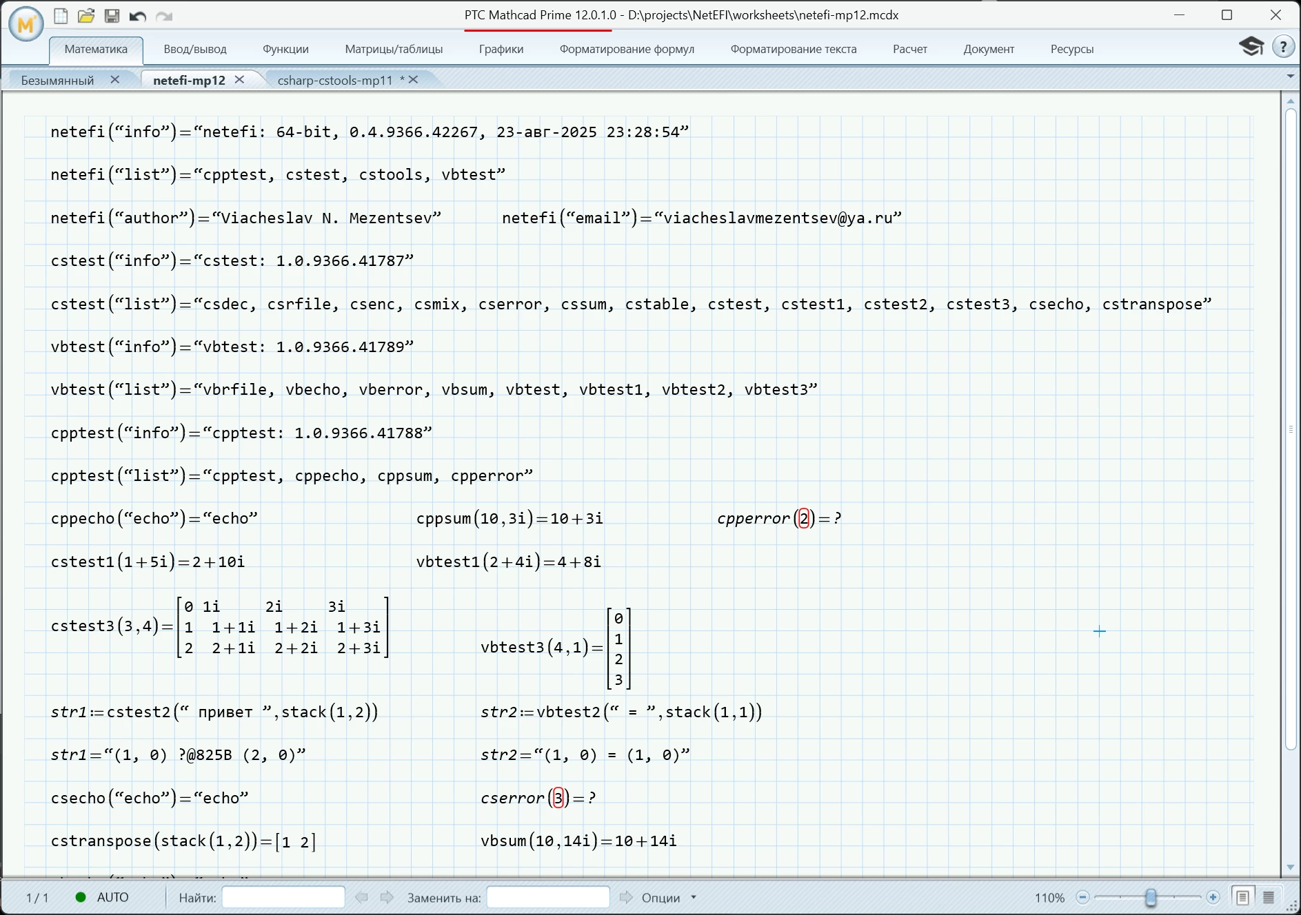

NetEFI Framework for Mathcad

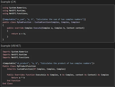

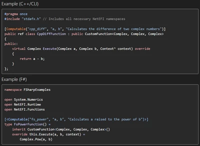

This framework allows you to create user-defined functions for Mathcad 15 and Mathcad Prime using any .NET language (C#, VB.NET, etc.). It removes the need to write C++ code, allowing you to focus on your function's logic in a familiar managed environment.
Key Features
  • Write in .NET: Develop your custom functions in C#, VB.NET, or any other .NET language.
  • Full Compatibility: Supports both the classic Mathcad 15 and modern versions of Mathcad Prime (via the legacy Custom Functions API).
  • Rich Data Types: Natively handles complex scalars (Complex), complex matrices (Complex[,]), and strings (string).
  • Easy Setup: The NuGet package automatically includes the required C++/CLI host (netefi.dll), so you only need to focus on your C# code.

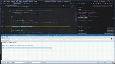

  • Advanced Features: Provides an API for error handling, logging, and checking for user interruption (Esc key).
    You need to make sure that the 64-bit version of netefi.dll gets into the folder during assembly.

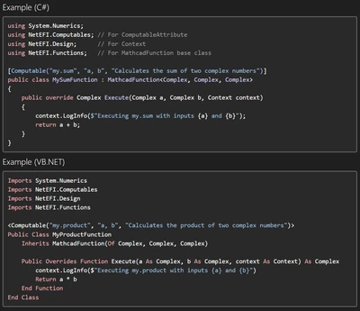

NetEFI.Framework 0.5.0
- New Error Handling System (Breaking Change);
- API and Project Refinements (Breaking Change);
- A new `context.Invoke<TResult>(...)` method allows for type-safe calls between custom functions.

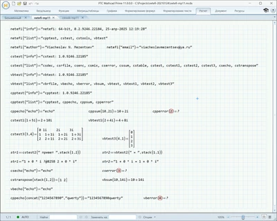

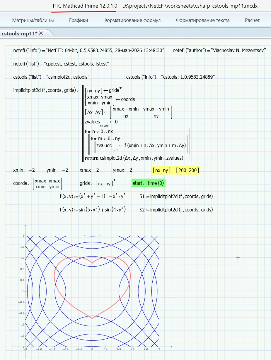

NetEFI example

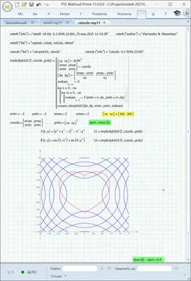

implicitplot2d example
