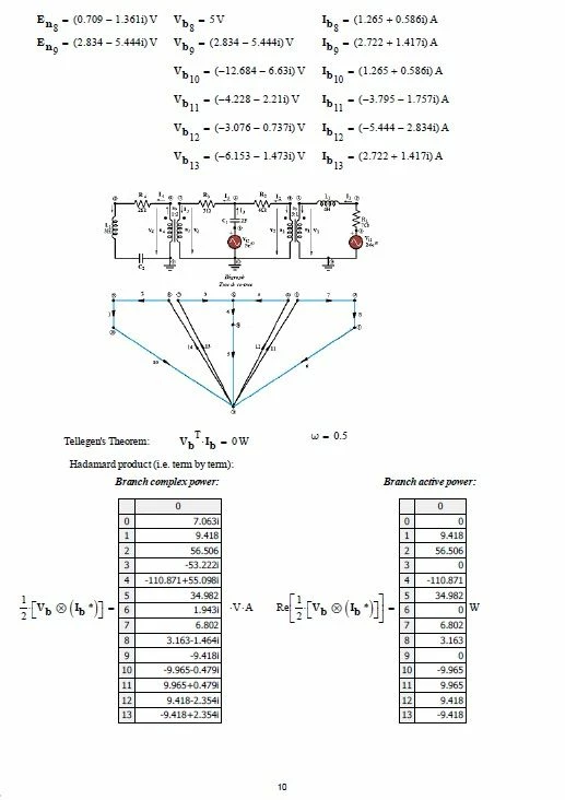

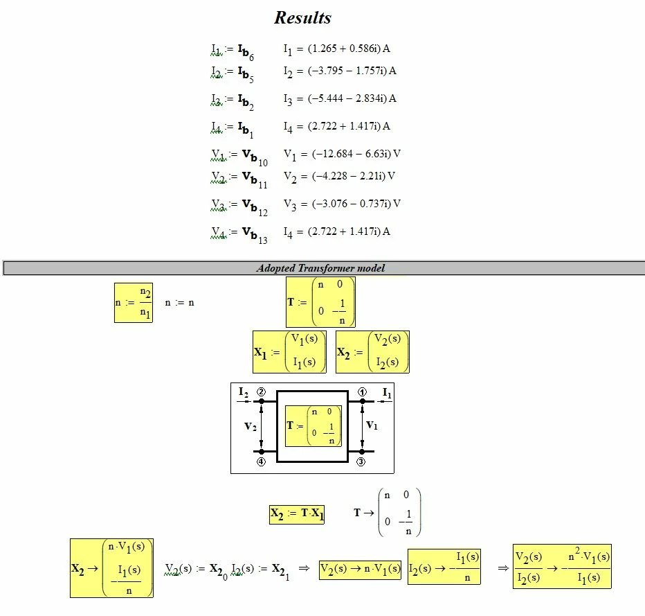

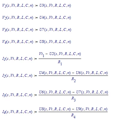

Ah, I used the wrong KCL around the transformers. After correction:
And with the correct values for Vi1 and 2:
The results now compare with those of ttokoro:

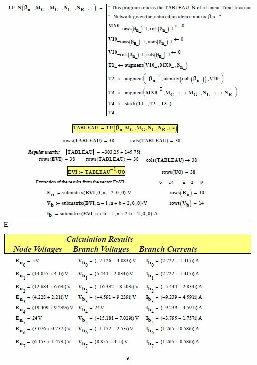

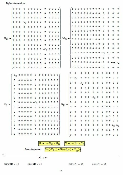

ttokoro
Jan 9, 2024 12:44 PM UTC
t.t.
ttokoro
Jan 10, 2024 8:26 AM UTC

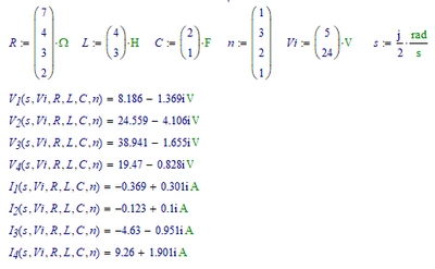

So, we have 3 diffrent answers!
Total Power from Voltage sources.
Total power loss by resistors.
t.t.

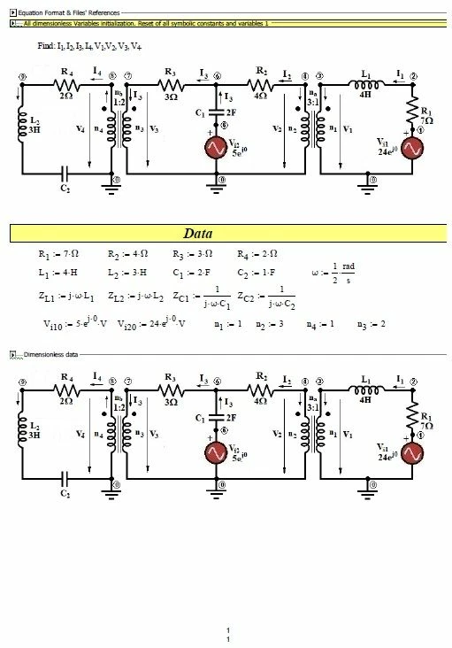

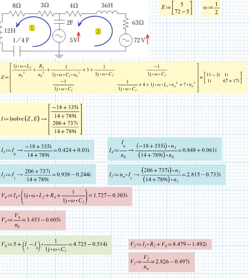

Jan 9, 2024 10:56 PM UTC

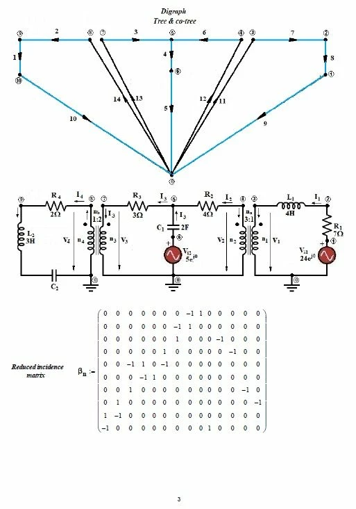

I get this:
Then:
and with:
23-Emerald V
Jan 10, 2024 11:00 PM UTC
On second view:
since both sources (Vi1 and Vi2) are DC, all voltages V1...V4 are 0 V, I2..I4 are 0 A and I1=24/7 A.

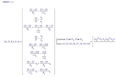

Jan 10, 2024 4:29 PM UTC
-MFra-21-Topaz IIAuthor
Jan 15, 2024 8:04 AM UTC
Based on the previous calculations, I get the following:
Calculations that don't match yours.

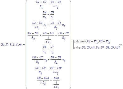

ttokoro
Jan 15, 2024 10:58 PM UTC
Your above one is right. I2=-I1/n. Therefore, if I1 is 1.265+0.586i, I2 should be 3.795+1.757i, instead of -3.795-1.757i.
So, your Kirchhoff's current law, KCL, is not correct. And n is not 1/3 but 3 for n1 and n2.
