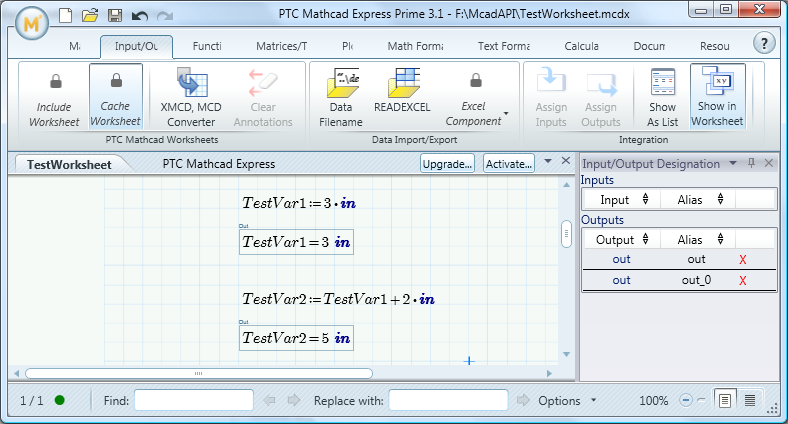

Oct 13, 2015 2:27 AM UTC
In the following (and attached) Mathcad file, you can see that I've defined two variables and assigned their results as outputs.  By default, Mathcad gives the outputs the aliases "out", "out_0", and so on.  These can be changed manually to something more useful (if anyone knows how to do this programmatically, that would save me a lot of work - please share).  When I run the script above, I get the following:
out    0.0762    m
out_0    0.127    m
tslewis13-AquamarineAuthor
