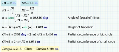

February 24, 2022
Here's a quick solution for the two circle problem.  Three circle can be solved the same way but needs a check on if the 3rd circle extends outside the belt.
February 24, 2022
Thanks DFJ for the nice and simple solution.

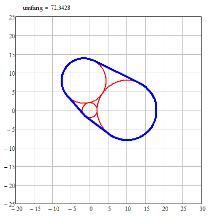

I would suggest a more generic problem.
Let's not limit ourselves to touching circles, and let's not limit the number to three or four. Let's find the convex hull of any number of circles in any position and find its perimeter.
Of course we can use the very same solution to deal with touching circles as well.
Here's a nice animation with three moving circles trying to escape the rubber band:
Lets see what you can come up with ..

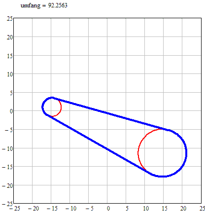

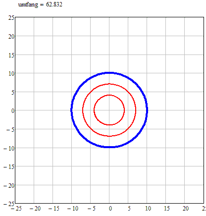

February 25, 2022
The function you are asking for is called "TouchingCircles" im my sheet - the rest is done by the already mentioned generic functions.
And no, I'm not living in Australia - no kangaroos here in Austria 😉
We call it "Senile Bettflucht" over here 😞
I'am waiting for other solutions.
My solution still fails in some special cases but I don't think I'll be interested in trying to fix that in the near (or even far) future 😉 It would require to add some if statements which usually ruins the beauty of the main solution 😞
And once the main problem is solved, my interest usually fades very quickly ...
Anyway - here is something for you to play with a bit if you like ...
BTW, a nice problem to solve would be a couple of circles in arbitrary position (not overlapping) and then wrap a rubber band around them and see how they move and come closer. But I guess that the physics involved here is beyond me and my resources.
EDIT (2022-02-26): The worksheet which was attached here calculated wrong values for the circumferences. Should be fixed in the new attached sheet.
