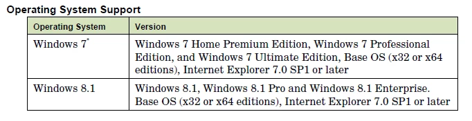

  • Windows 8.1 Support: PTC Mathcad Prime 3.1 supports the Windows 8.1 operating system.
OS Windows support:

So my home computer with OS VISTA might or might not work?
March 3, 2015
Fred,
I would highly recommend upgrading to at least Windows 7. It is a major improvement over Vista. I also wouldn't discount Microsoft from dropping support for an older OS shortly as Windows 10 is getting ready for market. They already dropped XP support.

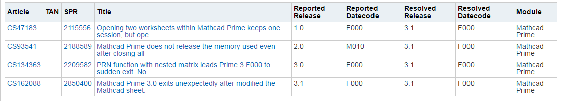

List of bugs fixed (resolved issues) for Mathcad Prime can be found by using "Update Advisor" tool on PTC's site, here: https://support.ptc.com/appserver/cs/update_advisor/update_advisor.jsp
And here is a short list for Mathcad Prime 3.1 F000 service release:
