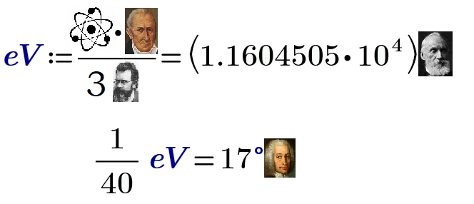

It will good to have in Mathcad new temperature units. Allen Razdow will be glad!
No!
I'm Spartacus!

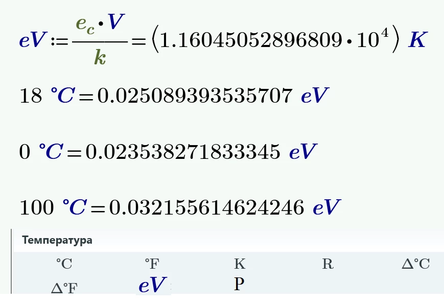

Stuart

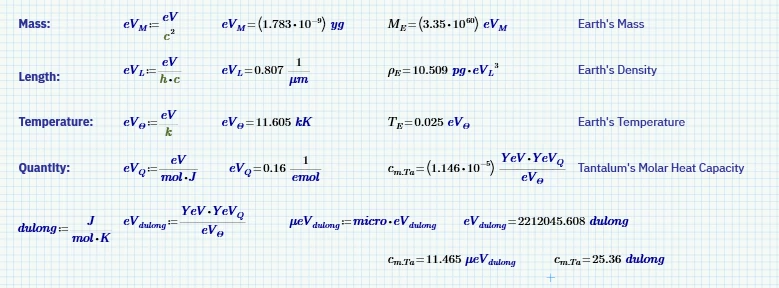

(No, the dulong isn't a real unit, AFAIA - it seemed a small thing to add it)

In spite of Stuart's scepticism, plasma physicists sometimes use eV as a measure of temperature!
(though I tend to share his scepticism!).

Moscow Power Engineering Institute: Mathcad Calculation Server (mpei.ac.ru)
it is my Mathcad on-line electrical cunductivity plasma calculation! eV as Tempertura (and kelvins).
