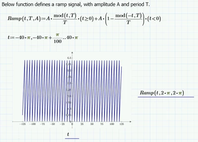

Try this:
March 29, 2021
can you explain what ramp really do or it's function?
March 29, 2021
Ramp is a mathematical function, It creates a repetitive ramp signal.
It allows you to plot the function over an arbritary time period.
But you could use one period of it to create the data for a Fourier series of the function. As such it should be able to replace ttokoro's function f(t).

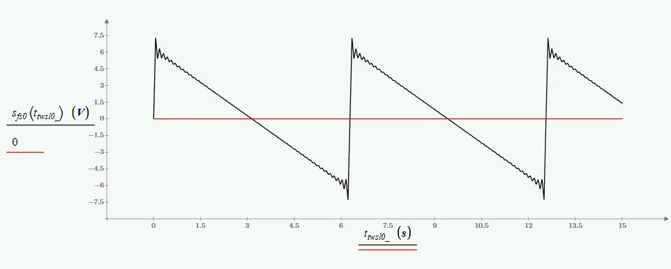

Attached you will find the worksheet for PRIME 7.
The file consists of three sections: the first concerns the input of all the data, the second the programs (subroutines) for the development of a given function in Fourier series and finally the third which contains the functions and graphs.
