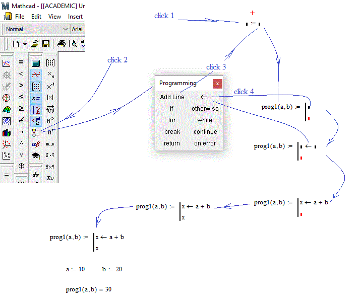

Mathcad 15 and Prime offer an extensive library of examples and instructions on how to use it, see the help. It has several toolbars that you can have at your leisure. I, for example, have arranged them as shown. Your problem, I understand, is to write a little program that performs simple operations. When you launch Mathcad it automatically opens an untitled worksheet. Click anywhere on the page, the red cross pointer will remain there. Then click on : (two points), the definition operator will appear: =. In the operator's right placeholder write the name of the small program you want to create, then click with the pointer to the right placeholder of the same operator. After that, click on the add Line of the programming toolbar..etc...see photo:
