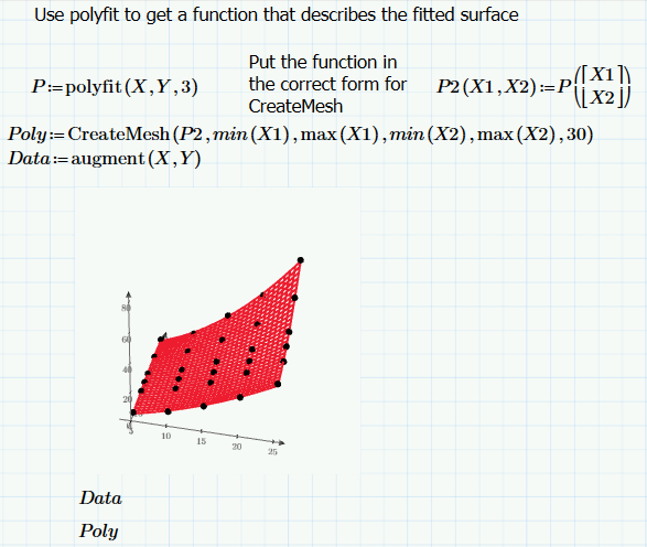

Newbie question: Can you help me get started on multivariate regression analysis?
Suffering as a new MathCad user. Can't seem to get started on a 2 independent variable regression. If I could just see an example sheet, I think I could get moving.

Which version of Mathcad are you using?
What sort of regression do you want to do (linear, polynomial, something else)?

Thanks for answering so quickly. I really am very new at Mathcad.
Mathcad Prime 2.0.
I assume polynomial will get me a good enough result.
Dean

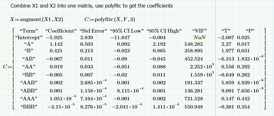

With function:
