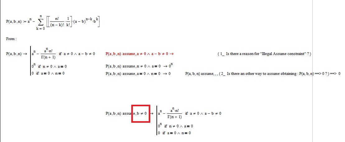

Newton Binomial.
   Hello, Everyone.

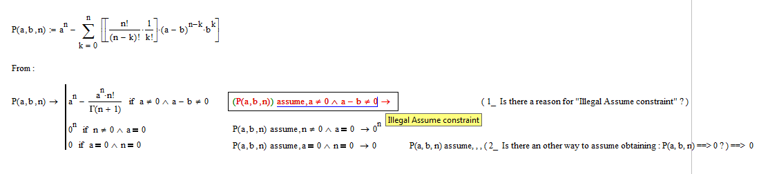

         1_ Is there a reason for "Illegal Assume constraint" ?
         2_ Is there an other way to assume for obtaining : P(a,b,n) ==> 0 ?
    Thanks in advance for your time and help ?
        Regards.
Try writing the following:
lvl10720-TurquoiseAuthor

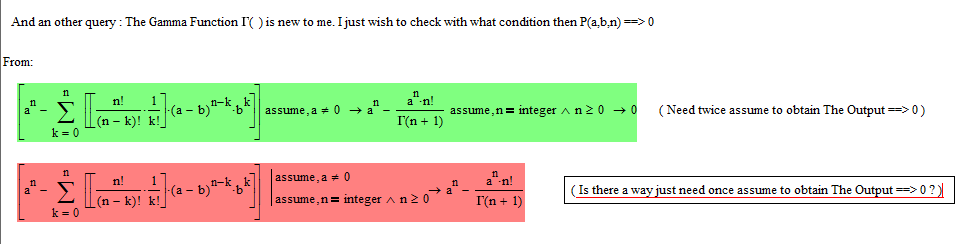

  And I have an other query :
        Regards.
