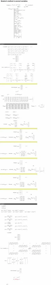

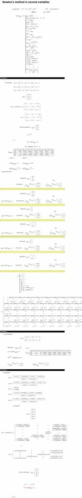

Hi!
Hereafter, there are some examples that use the Newton algorithm. Lastly, there is also one related to your problem. But it is the only one that is not soluble in the presence of a singularity.
Greetings
FM

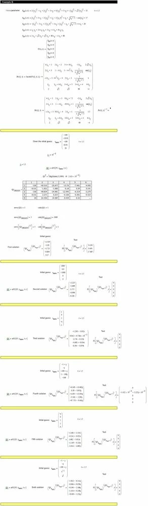

July 27, 2017
... in fact my results are very strange ... just look at the two examples attached.

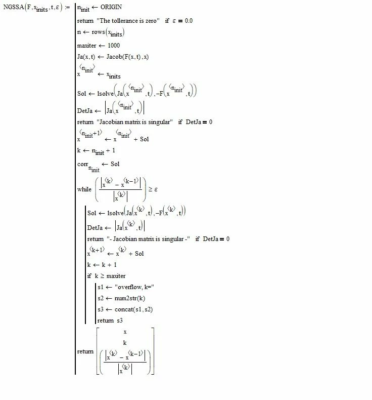

August 2, 2017
You can get the same results without calculating the Jacobian inverse matrix. See the following program:

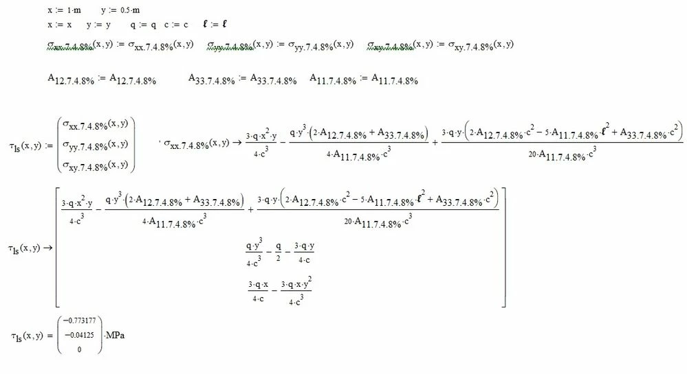

March 20, 2019
Hi
Thanks for help. But now I have special sample on the 30 page. Could you help me?
March 20, 2019
Hi ptc-3682623,
Answer to the first question:
Second question: Lambda is not defined.
