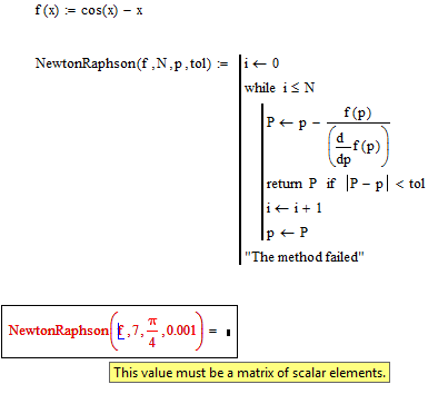

newton raphson method (mathcad 15) HELP
I'm having a problem with this code. Please help me. The file is attached.

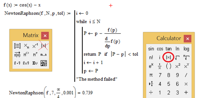

Apr 15, 2015 7:09 PM UTC
Your |P-p| expression was taken from the Matrix toolbox and is the determinant function. Select the one from the Calculator toolbox instead.

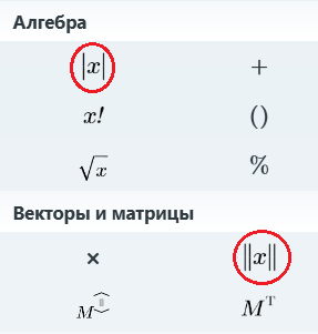

Apr 15, 2015 7:24 PM UTC
In Mathcad Prime we have two views of this two operators
Why? Visit please Mathcad Mad House
Apr 15, 2015 7:22 PM UTC
You've been very helpful. Thanks
