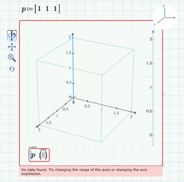

No data found for 3d plot
No matter what range i change i am not able to show 3d plot data. Anyways how's the range should be chosen for such scenarios

terryhendicott
Jun 10, 2022 8:47 PM UTC
It would appear you need at least two rows in the data to get a scatter plot!

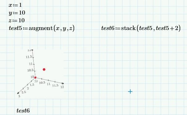

Jun 10, 2022 10:16 PM UTC
In real Mathcad plotting a couple of points was a bit awkward as it needed a nested matrix to do so. This was made a bit easier in Prime.
But Mathcad would also allow to plot a single point and this seems to be broken in Prime. On the other hand, the plot abilities in Prime, and especially the 3D plots, are not really to be taken seriously anyway.
A simple workaround, if you really want to use Primes 3D plot and plot a single point, is to plot the same point twice 😉

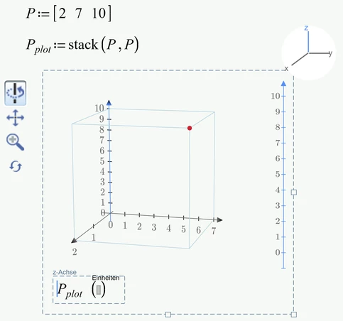

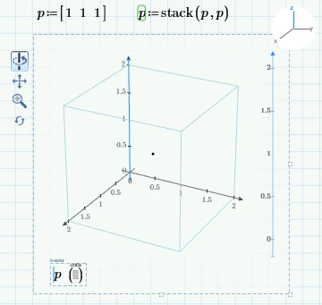

LucMeekes23-Emerald VAnswer
23-Emerald V
Jun 12, 2022 11:27 AM UTC
"Is there any specific reason"
Yes, Prime will not accept a 3D plot from a matrix with just a single row. It's because it (deliberately or inadvertently) was implemented that way:
The work-around (one of the many work-arounds that you need when working with Prime) for this shortcoming is to repeat the matrix row when you want to plot just a single point. This can be done by stacking:
