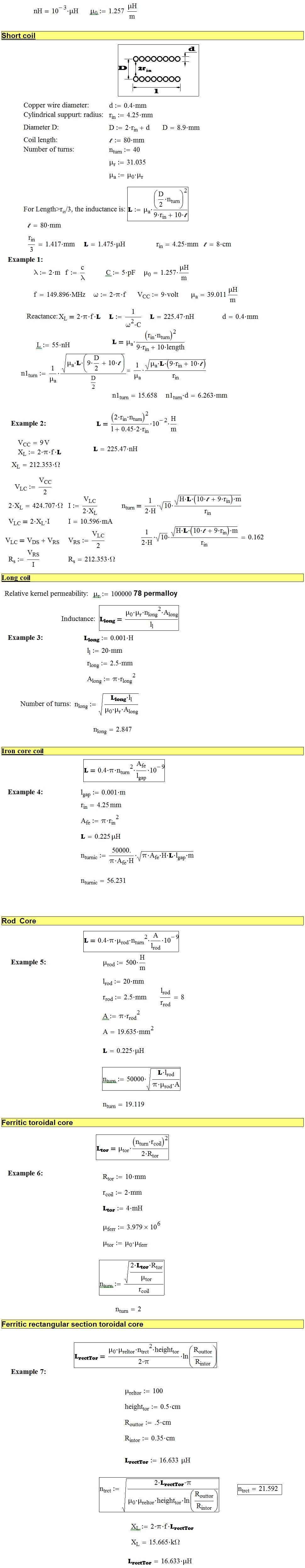

June 3, 2017
All formulas have not been verified.
