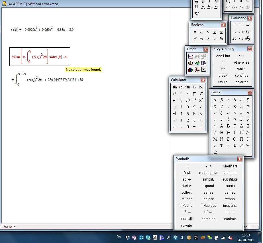

I have MathCad V.15, and theres one equation I can't solve. I've tried a simplified solution which works, but I can't figure whats wrong. Can you please help me?
See attachments.
Thank you.

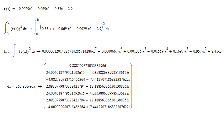

Another example of just how poorly the symbolic engine in Mathcad handles definite integrals. It can find the indefinite integral, so you can do the substitution for the limits by hand. In this case even that step is not really necessary though, because the lower limit is 0 and there are no terms that do not contain x.

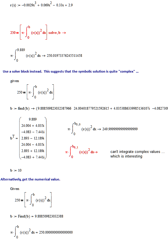

It's not clear to me what the symbolic processor does when given a solve block with find. Certainly not the same thing it does with the solve keyword.

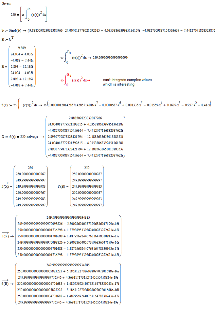

Hi Jens!
It should work the way you did it but it doesn't because of a bug obviously introduced with MC14.
I ran into the very same bug a short while ago -> Bug in Mathcad 15 M030 (symbolics)
You have already seen some workarounds and I may add another one. As the problem in the symbolics are the floating point decimal numbers, we can rewrite r(x) using fractions of integers. And - Voilà! Mathcads symbolics is capable to solve for all solutions, even though it switches to float display itself:
If you manually force it in float mode (even after solve), it fails again - clearly a bug!
Regards, Werner

Thanks,Werner - you've literally just saved me from doing the same thing!   I was idly browsing through the (non-compressed) mpl, lisp and mupad files and wondered whether the symbolic processor might handle a rational solution any differently.

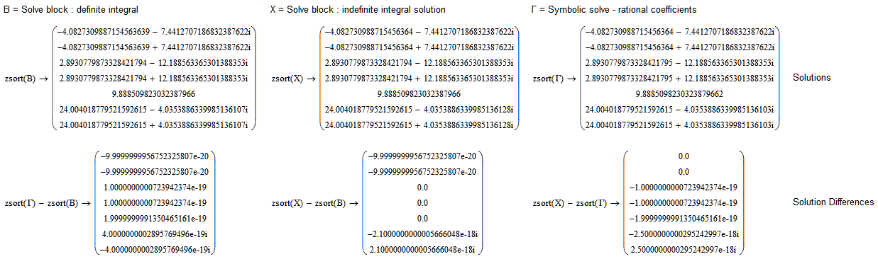

zsort is a simple sort function I put together to sort complex numbers by their Real values and sort any values with equal Reals by their Imaginary values, simply so I could look at the differences between the solutions..
Stuart
