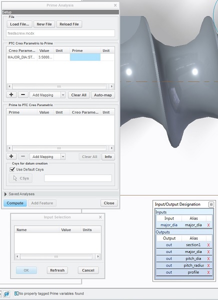

When setting up Prime Analysis in Creo 3.0, attempting to list Prime input/output returns the error "No properly tagged Prime variables found".
Variables have been set up in a pre-existing *.mcdx file and the file loaded in the Prime Analysis set up dialogue in Creo. On the Input/Output tab of Prime, I select "Show As List" and all my variables are listed, yet the Input Selection panel in Creo remains dismally empty. Am I doing something wrong or is there a system or compatibility error?
I'm also getting a "Quality Agent 3.0 F000 from PTC has stopped working" error at various times when using MathCAD and Creo.

October 20, 2014
Please contact with PTC's tech support by using "Mathcad Support Center", here: http://www.ptc.com/support/mathcad_supportCenter.htm
October 27, 2017
I am having this same issue, how did you solve it?
