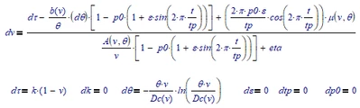

I am solving an ode. The calculation converges for some parameters but not for others. My problem is I cannot figure out why. There seem to be no obvious causes, e.g. like a denominator going to zero. I have looked at a number of other aspects without success. I am not mathematically adept enough to tease something out analytically, but maybe some one else is. If anyone has any insights or suggestions, I would appreciate it.

There's no tau in the set of differential equations:
It results in no y2 in the set D(t,y):
Could that be a ( or, the ) problem?

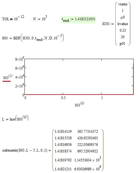

Using your IC03 seems to fail for t.end larger than the value seen in the picture below.
Looks like the derivative is exceeding numerical limit and going in direction infinity at this position.
BTW, you know that writing TOL=10^-12 has no effect!? The default value (10^-3) still is in effect. You would have to use the three bars global definition "equal" sign if you wanted to see the effect of changing the value of this system variable.
Luc and Werner,
Thanks for taking a look and for the suggestions. In case you are interested.....It turns out the problem was with the function Dc which goes to zero with large V and causes the solution to blow up (as you noticed). In this case, the problem actually becomes ill-posed - no stable solution exists.  Because of this the non-convergence is not surprising. So the problem really had nothing to do with MathCad (except it helped revealing and tracking down the problem). I alleviated the problem by replacing Dc, which was a linearly decreasing function of ln(V)V (on the basis of experimental observations) by an exponential which agrees with the linear function for small ln(V) but does not go to zero.
