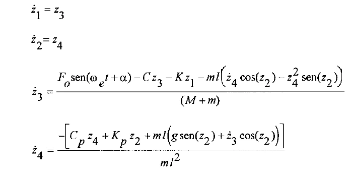

Hi LucMeekes, thanks for your answer.
But how to expand the vector? The problem have two defree of freedom, I don't know how to expand the vector using Rkfixed comand

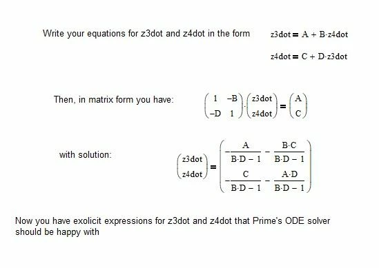

I can't see your Prime file, but judging by the PNG file, you need to do something like the following:
(for "exolicit" read "explicit" !!!)
Alan

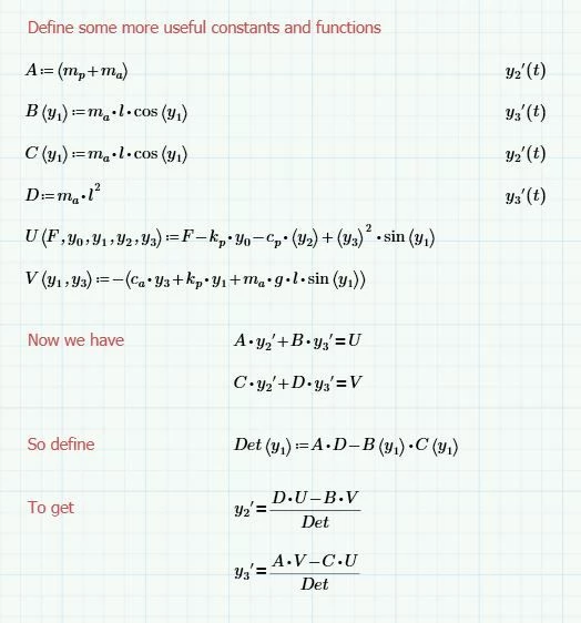

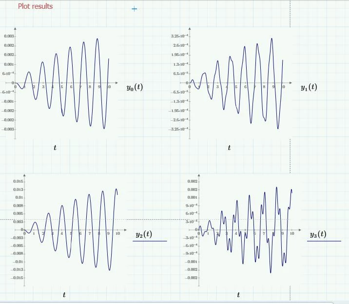

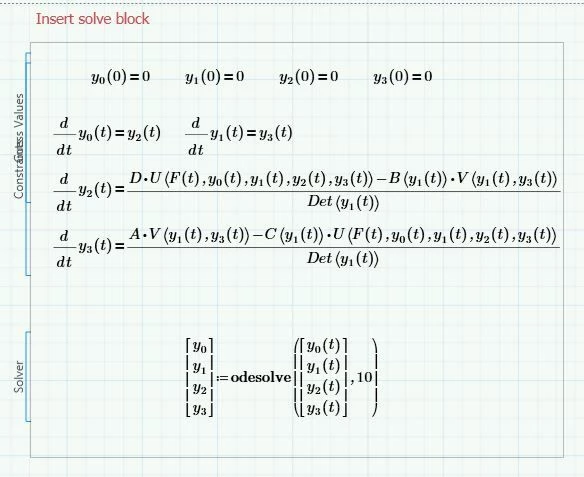

Thanks Luc,
Attached is my Prime 2 working version (no idea if the results make sense or not!!)
g0.JPGg1.JPGg2.JPG.
Alan
