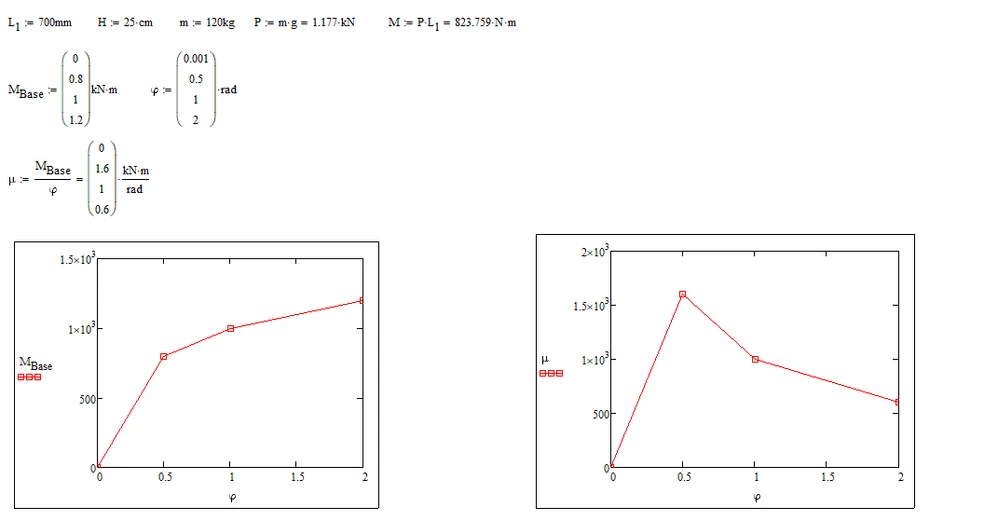

I need to solve a non linear equation in mathcad 15.
InputInput
After a physical test, I obtain the Mbase and phi value, that I use to determine mu trend (right graph).
I after need to use the mu function in a non linear equation, to determine the equilibrium configuration of the structure.
NL equationNL equation
How can I use the mu(phi) function in the NL equation? if I set mu as constant I don't have any problem.

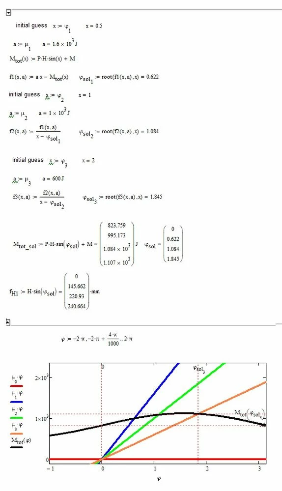

Here is the worksheet.
Greetings FM

Dear MR,
thanks for your reply.
I don't need to find the solution in previous point, but I would like to define a mu function from where the non linear equation catch the value for the numerical solution.
The mu parameter is not constant but vary with the rotation (phi), so I need to create a spreadsheet that automatically iterate the mu function.
If the function was defined, I don't have any problem, but in this case, the function is defined by data points, and I need to interpolate this value to solve the NL equation.

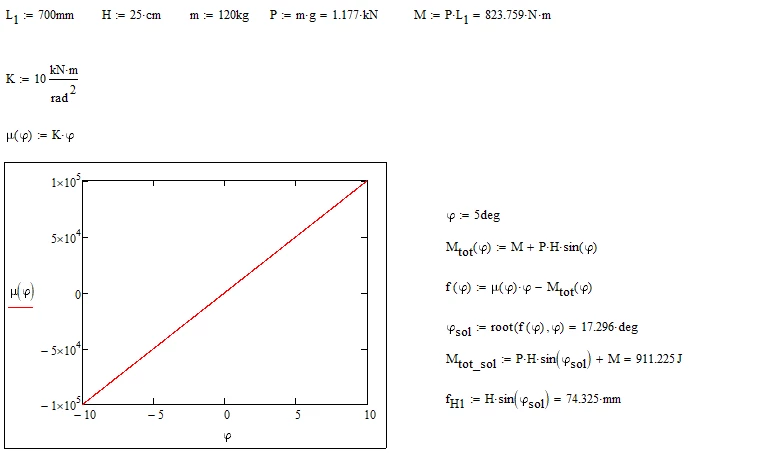

For example:
NL solutionNL solution
Now mu is a function of phi and the NL solution is reported in the previous picture.
I don't know how can I create the mu  function by data point that can be used in the NL equation.
Best Regards
