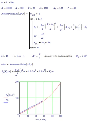

Please see the attached Mathcad 15 file. I am doing incremental solution formulation to trace a nonlinear curve.  the only step that i am not sure about is how to plot the  incremental solution (blue curve). I appreciate any assistance!

Something like:

LucMeekes23-Emerald VAnswer
23-Emerald V
Something like:
SFares14-AlexandriteAuthor
Thank you so much Luc!
