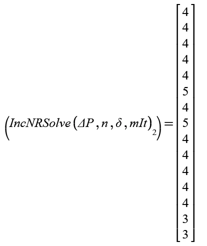

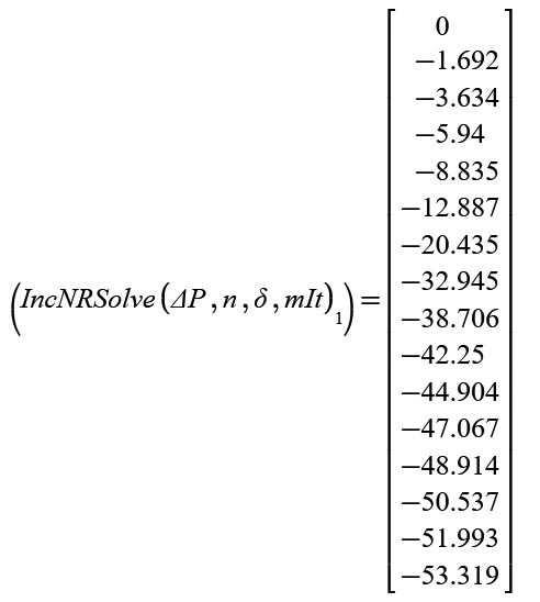

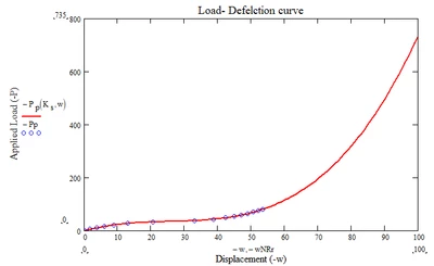

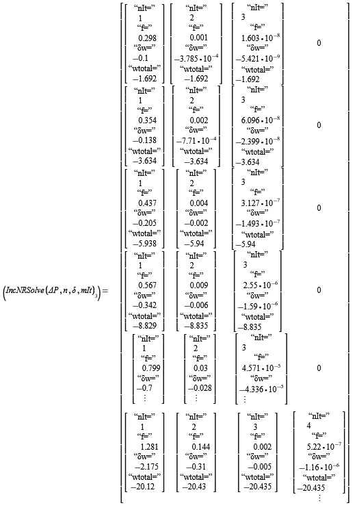

Attached is a Mathcad 15 file. It is for incremental/ iterative solution using Newton-Raphson method to trace a nonlinear curve.  I am using another example that has a solution. It is enclosed in the sheet.
1. I am unable to plot the curve resulting from Newton-Raphson.
2. i don't know how to plot the graph "number of Iterations" vs. "Increment"
3. I don't know what " While 1" in the attached file mean.
Both solutions are included in the attached file but i am not able to generate them.

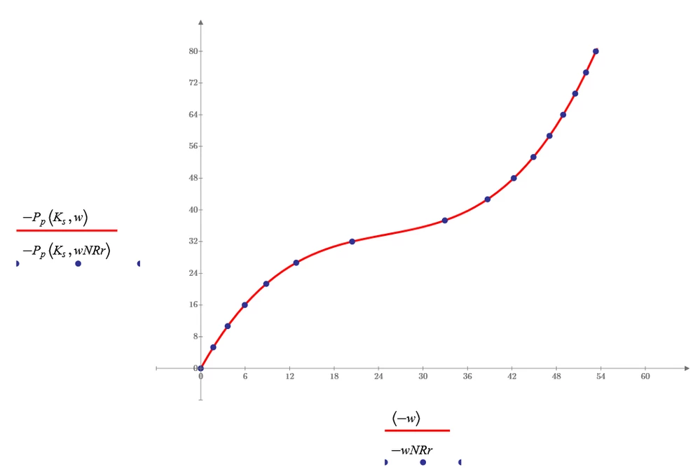

@SFares , please see attached.
Now with that correction, and an additional:
You can have your plots:

1.2.:Please save your sheet as a Mathcad 11 (.mcd) file and attach, that'll save me a lot of retyping.
3: while 1 means forever. Then there must be another provision to exit that loop: break if .... does that.

Unfortunately, I don't have Mathcad 15, only Prime 7, but as far as I can tell ...
You need to plot it as a second trace within the plot (also change w's upper limit from -100 to 60).   I think in M15, you just need to type a comma after your current arguments and type the second ones.  You need -Pp(K2,wNPr) on the y-axis and -wNRr on the x-axis.   Change the line type of the first item to a thinner line, and add symbols to the second trace.

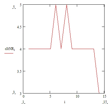

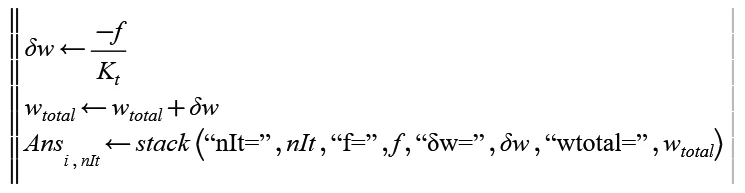

First fix the error in your return value.  It should read ( clt[i ) <- nlt, not clt[( i<-nlt ).
Then plot cItNR[i (y-axis) against i (x-axis).
As Luc's explained it just means "loop forever".  The escape clause is, as Luc guessed, the "break if |f| ..." line.

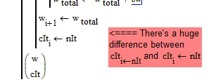

There were a couple of mistakes you made right off the bat:
1. You made the nIt assignment in your program to the index instead of the cIt holder.
2. The w and cIt holders were of different vector sizes.
You can plot all three sets of information on the same plot like I did, or make a separate plot for the Iterations.
As for the while 1, I don't know why it's even there since it will always evaluate to true since 1 is greater that 0 any day of the week. I would have keyed on the iteration parmeter so the program would not have chance keep on iterating beyond some reasonable value, like maybe 10 or 20. I didn't mess with it.
