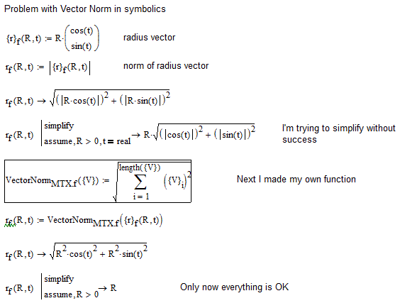

Norm vector problem in symbolic

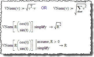

Try using "simplify,max"
Here are some suggestions for a user defined function
ifomenko1-VisitorAuthor
August 21, 2017
I know about all these suggestions about vector norm and I tried all of them but only one I wrote in my question gives good result without simplify, max.Thank you one more time for your help:))I'll try simplify,max.
